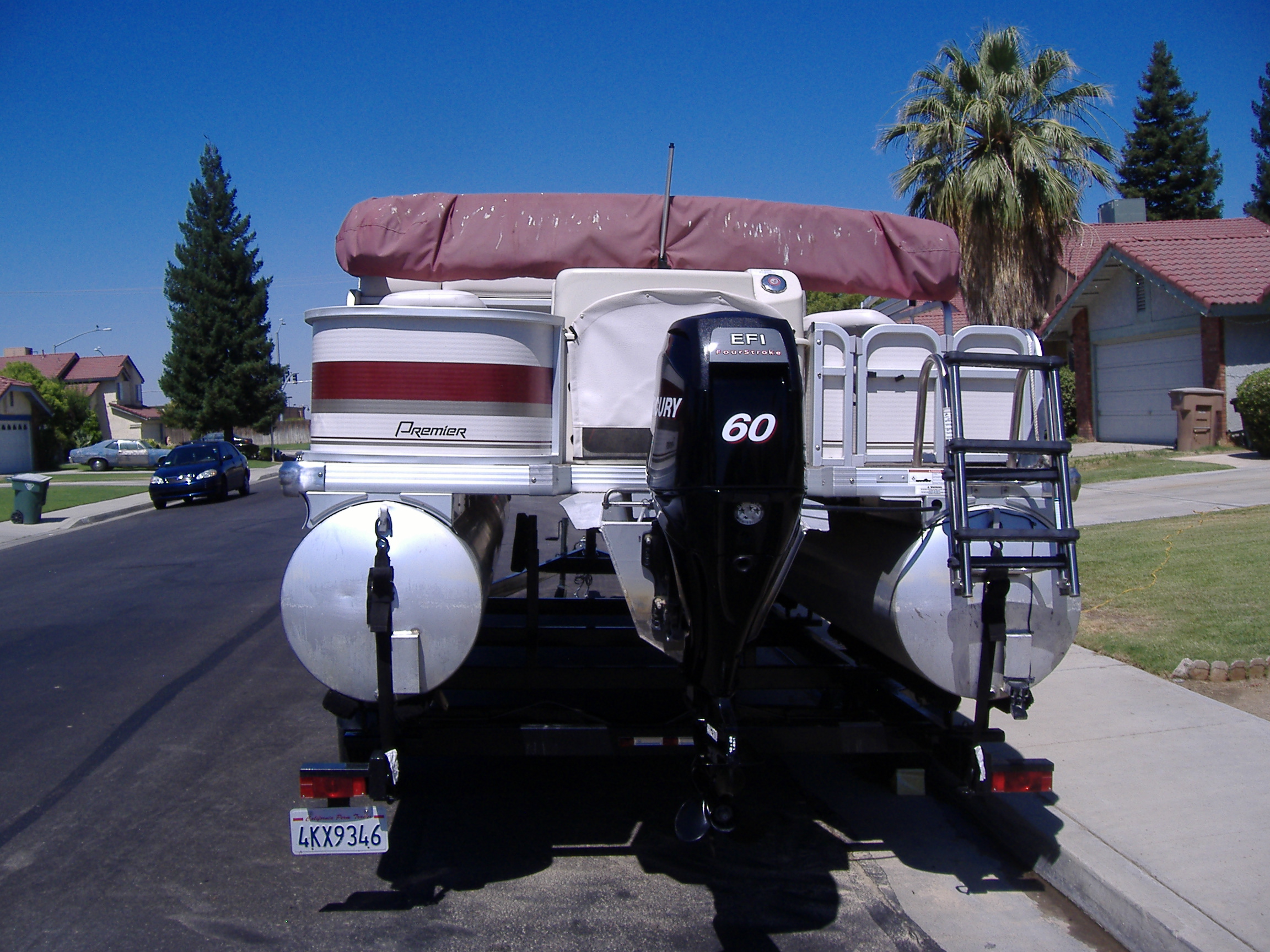

mine was already on the toon when I got it , I am the 2nd owner.
look on the rightside toon down low it is black , I don't know if it is a good spot?? I am planning on getting a newer fish finder soon.
