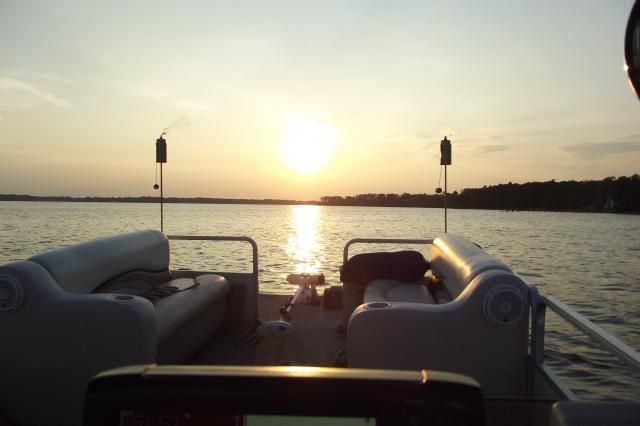

Still cleaning up the wires, putting them in covers but for the most parts, she's finished. Using the stereo wires ran two speakers off the front of the boat and two off the rear. Amp is connect to the low pass so unless the amp is on only the outside speakers work for enjoying music while swimming. :) Best of both worlds.
Tiki torches are from Lowes. Stainess and yes they really work. :)
AND THE SKINNY DIP LIGHTS> :) 4 ,, 6.5 inside JL Audios 4 , 6.5 Kenwoods on the outside of the boat Like mentioned, two in the front two in the rear. Use a piece of starboard 1/2 inch think fitted to the door and screwed in so the two and the sub behind me driving would not rattle. With the two in the seats facing you and those behind you that is one awesome sounding stereo. For those of us that like to Rock,, anyway. :happy :thumbsup
