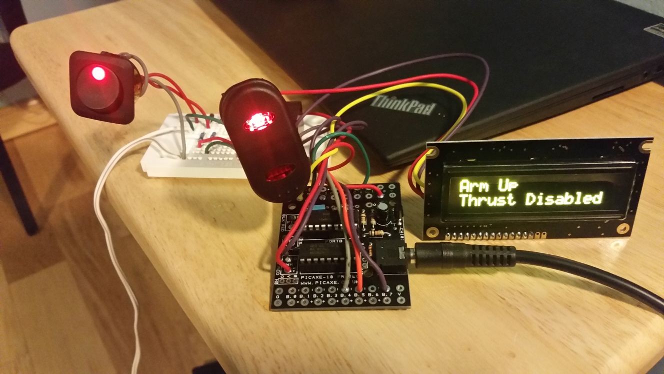

OK, so I've built a bow thruster for the pontoon.
Being the electronic hobbyist that I am (now that I am no longer an electronic engineer), it just makes sense that I would build a microcontroller-based control box for it.
It's mostly complete!

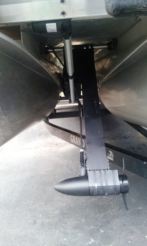

Let's see if I can post the business end again...

So it works. I just used a bunch of relays to control it last season, and a 200 pound actuator - which I had some issues with burning out actuators. Now, with a microcontroller monitoring the progress of the actuator, and the current it's drawing (and an upgrade to a 1,000 pound actuator), I don't expect to have any more issues with THAT!

The PicAxe microcontrollers are super simple to work with. It's really weird to be programming in BASIC, but one language is as good as the next, as far as I'm concerned. Talk about dichotomy - I program in C#.NET at work. While I've never programmed in BASIC for a living, it's the first language I learned, back in 1973 or so.
It doesn't LOOK like the BASIC I learned 42 years ago!
if ArmDownSwitchIn = 1 then
; Lower the arm
if ArmStatus != StatusDown then
ArmDirection = DirectionDown
DesiredPulseCount = 0
Gosub MoveArm
endif
else
; Raise the arm
if ArmStatus != StatusUp then
ArmDirection = DirectionUp
Gosub MoveArm
endif
endif

tuned wrote:I looked up PicAxe and it does look marginally easier to muddle through. It also looks like the chip could be flashed via USB, which would simplfy things greatly.
Exactly. I tweak the code, and write it back to the chip, which immediately starts executing it. Makes for very easy debugging and incremental development. Very cool that you have direct control of the input and output pins from BASIC (and analog to digital conversion as well!)
