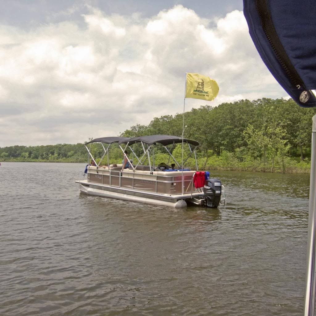

Thanks for all the replies! I stopped by my storage unit but the motor is too close to the wall for me to tilt it up in there. I don't think it will hit the ski tow bar ( avatar pic) though. I do know the boat seems to sit pretty low in the water in the back to the point I thought it was too low. I will try to get so e pics when the weather warms up and I can get out on the water. I'm thinking that maybe there is a limit on it to keep the front of the motor from hitting the floor of the boat when fully up?

It looks to me like your motor needs to come way up. Of course the only real way to tell is inspect while under full throttle, but judging by your water line and the fact that you don't have a full center tube I'm guessing it's on the low side. A 150 is a lot of weight, and 3/4 center tube boats are obviously going to sit lower in the rear. The last toon I built with a sport center I had to move the 135 Evinrude up as far as it would go to get it to run in clean water. This is just a guess, but I think your motor may be mounted as low as possible so it will clear your ski tow.
Check the tilt when you get it out, and go from there. If in fact you can come up a few notches on the motor it might not only solve your mooring problem but pick you up some MPG and MPH as well.
