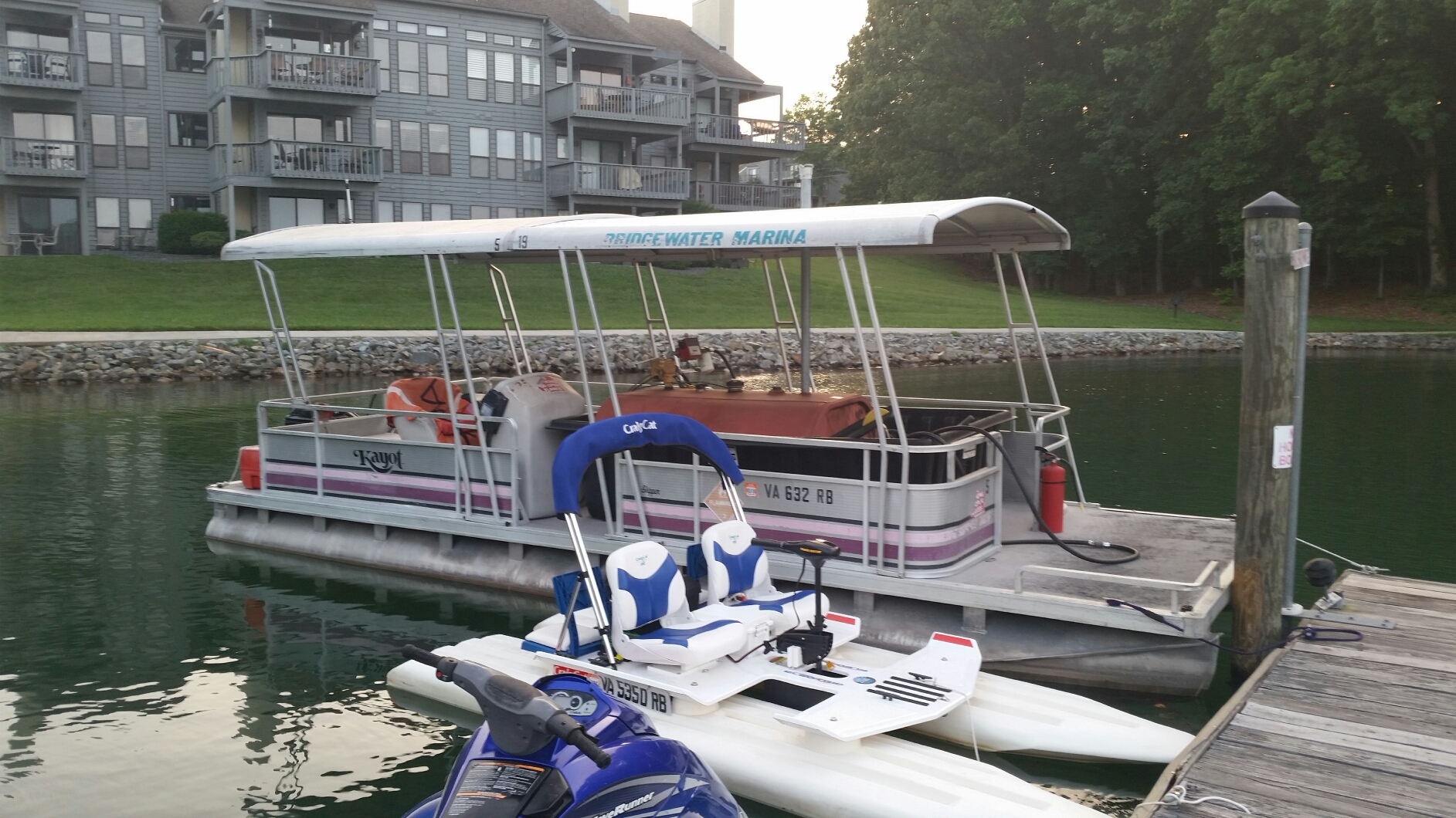

24' Fun-Toon that I got almost a year ago is in the photo in the water. It has a Mercury 115 2 stroke. I just picked up the 24' boat on the trailer to use as a doner for a 3rd toon. I'm planning to use the hard top along with the hard top that I already have to also have a roof over the front half of the boat.
I would like some opinions on center toon placement. The boat currently rides pretty low in the back but that will change some once I add the front hard top and front seats. Should the center toon be even with the outer toons or should I let it hang out of the back a little?

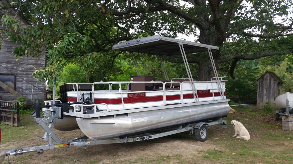

Donar boat

mine hangs out back about 1.5 feet (center tube is a 22 foot log, the side tubes are 20 footers). I like the way it adds more buoyancy in the back, but also wonder if I am not compromising performance by forcing the front into the water. I have only ever been on one tritoon (mine) so I cannot really offer an experienced answer for you.
That is a great idea for the top(s), I am excited to see how it turns out.
What kind of speed are you getting out of you 24 footer with the 115hp?

Yes, I wanted to find a longer toon for the center but this package had everything I needed including a trailer. My top speed so far has been 22 mph. I don't have a tachometer yet so I don't know what kind of rpms I'm turning at WOT. I think it's just the factory prop. Hoping to get more speed in the future.

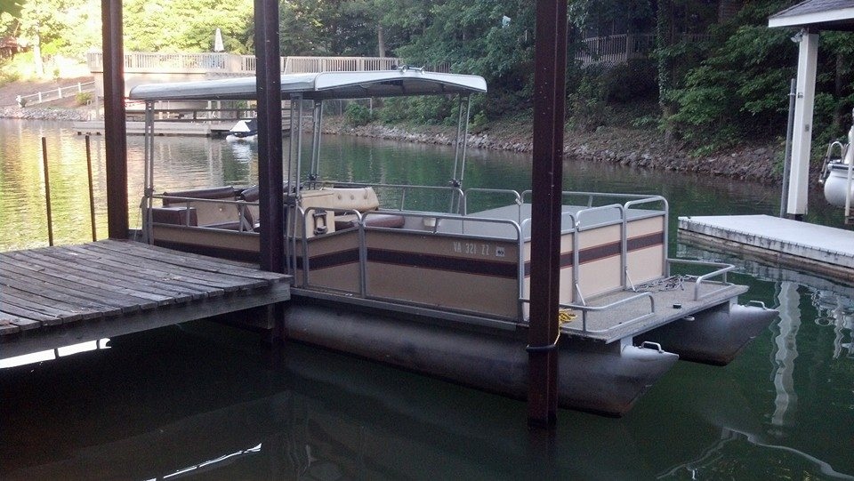

Here's a fuel boat at Smith Mountain Lake that has 2 of the round style hard tops. I'm planning to run a cedar board down each side to tie the two tops together.
