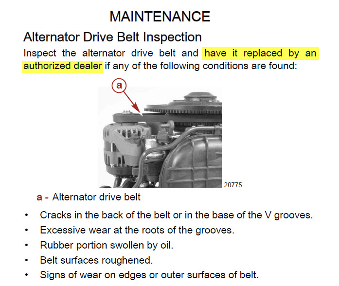

#4 Post by BobG » Tue Oct 06, 2015 11:40 am
Here's the page from the owner's guide. My 115 4 stroke (a 2012 model) is obviously different than the one in your maintenance manual link:

#5 Post by curtiscapk » Tue Oct 06, 2015 12:52 pm
sure looks like it would fit over to me. Have you tried to see if it will fit once its over loosen the alternator and fish her on the pulley and tighten her up :donno :o :?

#6 Post by BobG » Tue Oct 06, 2015 2:08 pm
Well, of course, I could just try to fit the new belt over the flywheel... :idea:
I just haven't had the new belt in hand at the same time I've had the cover off, so I figured I'd see if anybody here could answer the question. Both the boat and the belt are about 30 miles from my current location.
