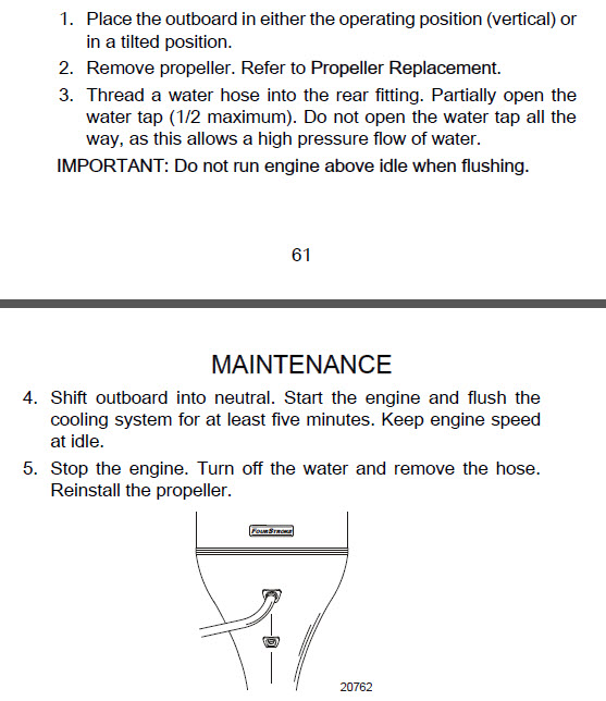

No ear-muffs required on that Merc 115 ELPT - there's a place on the back of the motor where you can just screw the garden hose in. Not all Merc's have this, but the 115 ELPT definitely does.

BobG wrote:No ear-muffs required on that Merc 115 ELPT - there's a place on the back of the motor where you can just screw the garden hose in. Not all Merc's have this, but the 115 ELPT definitely does.
I have a similar hook up with a garden hose 'screw in' fitting. I was told by my dealer to use this for flushing the motor after saltwater use. And, DO NOT start the motor with this connection. Use ear muffs at the water pick up down below near the prop. Using just the upper hose fitting and running the motor will damage the impeller/water pump. At least that's how it works on my Yamaha VF115. Maybe Mercs are different...

Thanks to all for info Yes there is a motor flush after salt water flush but it is strickly for flush out the salt water. Dealer advised NOT TO START motor while using flush out for salt water fitting. Mercury and dealer both advised use EAR MUFFS at intake vents when starting and running engine, when engine out of water (at home).
No, mercs are the same. I was told same thing at delivery of my merc four stroke,

#8 Post by BobG » Fri Oct 30, 2015 10:32 am
brumbyvet wrote:No, mercs are the same. I was told same thing at delivery of my merc four stroke,
No, we've been over this.
It's right in the manual.

+1

#10 Post by brumbyvet » Sat Oct 31, 2015 6:19 am
That is for saltwater flush, I'll still use muffs but you do what is comfortable for you.
