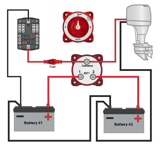

Here ya go, try this :donno
battery switch.jpg (92.58 KiB) Viewed 4575 times

Capt Sully wrote:Here ya go, try this :donno
This will be most helpful Sully. Thanks.
