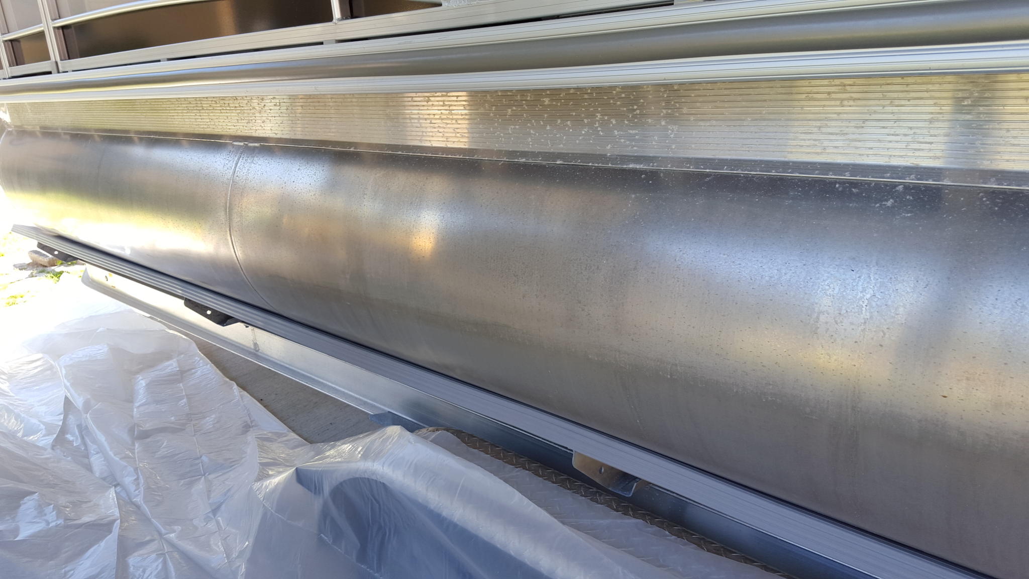

So since buying a brand new Berkshire Tri-Toon in August, I was witnessing the shine of the toons fading rapidly. The saltwater environment is tough down here. I kept thinking about Shark hide or another product, but procrastinated. Finally this past 2 weekends I got busy with it. I am content with the level of shine I brought out, I wasn't trying to make them a mirror, but I wanted more than the off white appearance after the acid bath. Most importantly, if the protectant performs as well as all the reviews I have read, I won't be bothering with them for several years to come, other than its normal bath after being out. In retrospect, I would say to anyone purchasing new, do something prior to putting the boat in the water, especially SW, not sure how quickly freshwater lakes will discolor the toons. If I had ANY idea how quickly things would change, and HOW MUCH work was involved in the polishing process, I wouldn't have hesitated for a moment either doing it myself, or letting the dealer apply the shark hide. Hind-sight is 20/20 right?

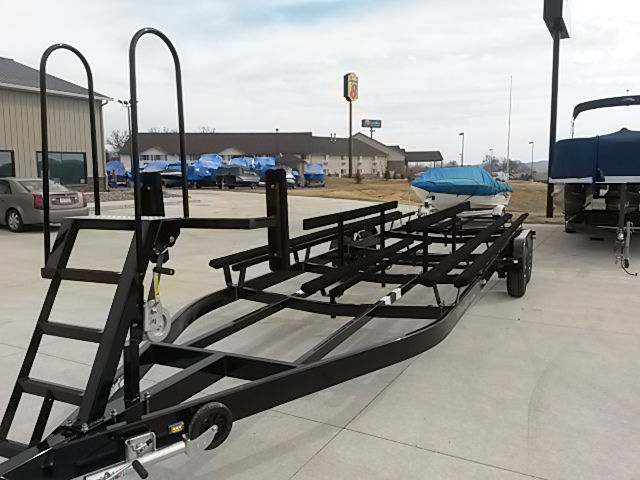

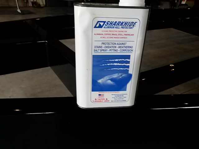

For what it takes to apply the Sharkhide and the cost of it, ya, he is dinging you pretty hard. The hardest part is to pull it off the trailer. It takes maybe 1/2 an hour to apply it to a new hull. As long as the hull is clean and has no "Factory Applied" sealer. You can tell if it has been sealed by dipping a rag into lacquer thinner and rubbing it on the pontoon. f you see some stuff rubbing off and dissolving going on, its already got a coating on it. I did my brand new trailer yesterday, took 20 minutes, and it was a pain. Pontoons ae much easier. I would say $250 to $400 would be about right.

I appreciate the info. The dealer is trying to tell me that it takes two of his guys a couple of hours to put it on, but clearly that is not the case.

Oh god no! If you lived close to me, I'ld do it for you. Its soooo simple and easy to use! If they are not factory coated, its very fast! Hit them with a little lacquer thinner to clean them, pour some Sharkhide on a rag and apply it from the front to rear, in one long swipe at the top and work your way down. Let it cure for 24 hours and hit it with another coat, if you can see missed spots.
