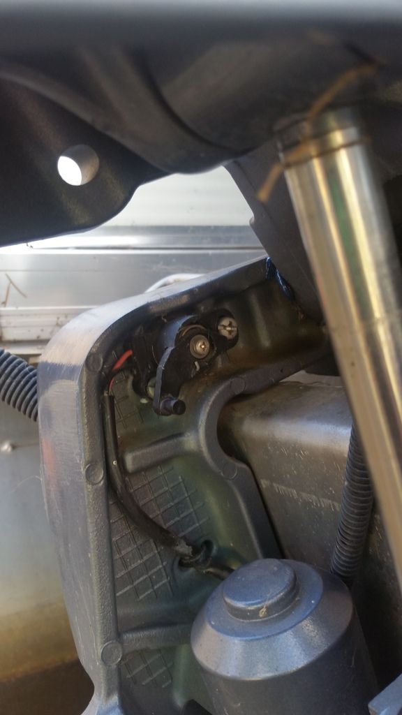

Just curious, is part of the sender system missing on my motor? It doesn't follow all the way up. If not, what is the way to adjust it so that I don't have to rubber neck? Thanks
<a href="http://s1301.photobucket.com/user/cleat ... j.jpg.html" target="_blank"><img src="http://i1301.photobucket.com/albums/ag1 ... su1b0j.jpg" border="0" alt=" photo 20170416_151402_zpsgpsu1b0j.jpg"></a>
Yamaha T60 trim sender adjustment

I was thinking most engines have a trim gauge sender on the side of the powerhead--round thing. They turn so you can adjust the limits on the engine trim.
Pontoon boats are a little different than most fiberglass boats in that the transoms are not always vertical--engines can be mounted at a negative angle. Thus the adjustment would need to be made.
