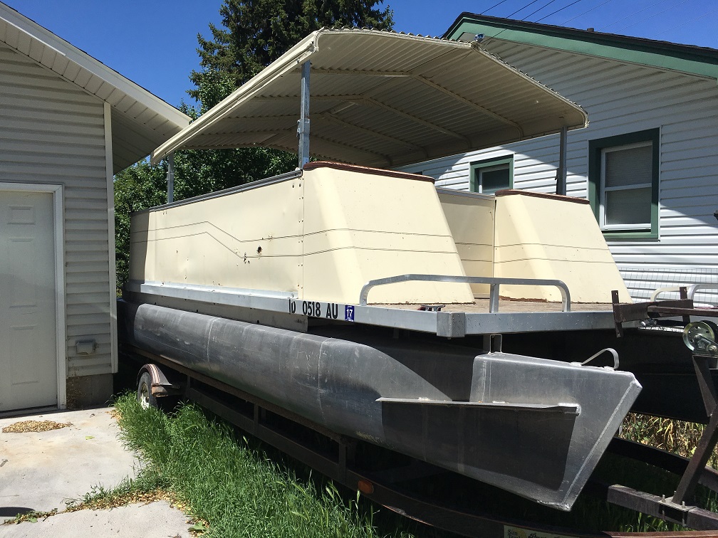

Sorry for the huge pic. lets try this again.
- File_000.jpeg (275.37 KiB) Viewed 8514 times

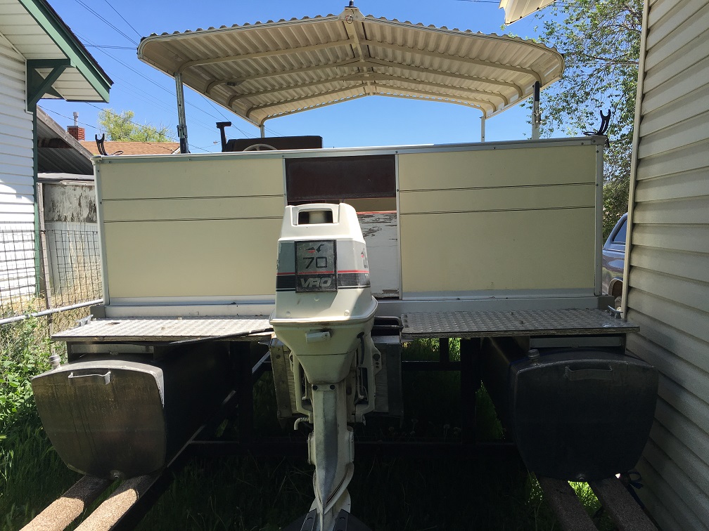

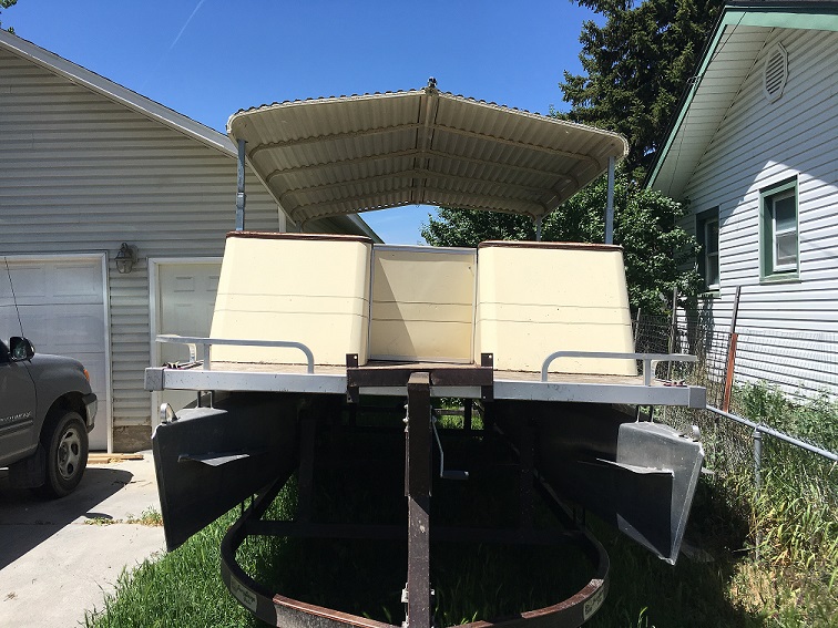

And some more photos.
- File_004.jpeg (306.29 KiB) Viewed 8509 times
- File_003.jpg (193.49 KiB) Viewed 8508 times

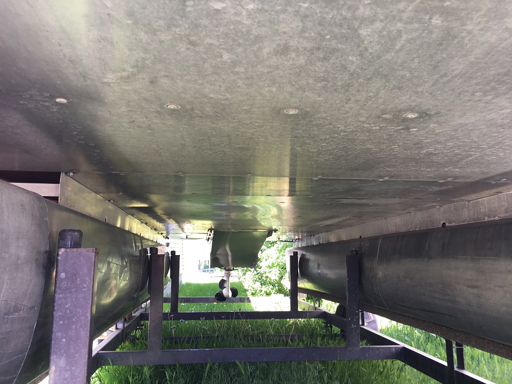

And this.
- File_002.jpeg (278.59 KiB) Viewed 8505 times

Yep, you've got an early version of a pontoon boat that was somewhat ahead of its time--styling wise. You've already got underskinning that makes the boat ride quieter and smoother.
Your toons are more square than they're round, and they've not made them that way for a long time. The engine pod appears also to be square where newer engine pods are more pointed and more "waterdynamic." That may be the reason for funny waves coming out of the rear of the boat.
Many of the earlier pontoons had transoms laminated out of two 3/4 inch marine plywood glued together and held in by aluminum angle drilled and bolted with stainless steel bolts. By all means replace the transom as you don't want to lose the motor because it fails.
I would hesitate to put big money into such an old pontoon boat--if you're thinking about refencing and new furniture. My neighbors have an older pontoon and a newer pontoon, and they chunked their furniture and replaced it with folding chairs. It works, and the folding chairs were cheap.
If you boat performs acceptably (5500 rpms or more) and doesn't have propeller ventilation, just leave the engine height alone. You could be opening a can of worms raising the motor.

Are those bullet holes in the side?
Re: Some questions from a new toon owner
That boat looks to be in good shape for as old as it is!
