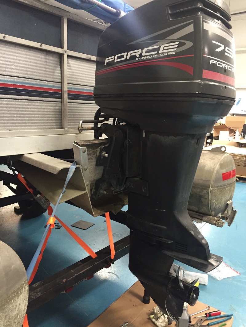

I'm sure someone with more knowlege than me will come one soon. However, I have a 1988 Harris with a 1997 Force 75
I'll have to look at my picture (unfortunatly my boat isn't close.) to see where the cav plate sits. Mine will do 18-19 mph (GPS) with 7-8 people on-board.
So I think your on to something bringing it back up. Mine has some space to go lower so I know it is up high compared to yours
