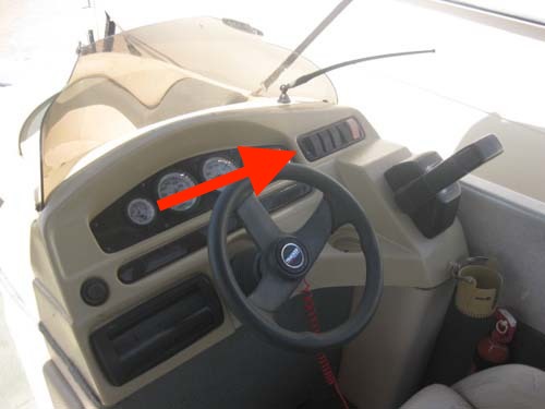

I bought this deck boat used but I am trying to troubleshoot some electrical problems and Tracker doesn't have manuals for this specific boat.
Can anyone help me ID what these rocker switches do? They are not labeled on the back.
I know this much
Far left: the only three position switch
Far right: horn
Here are some I am not sure about:
Livewell pump
bilge pump
lights
I can get photos from under the console if that helps. I am assuming this setup is on a lot of tracker boats and is a standard layout.

The 3 position switch is most likely for the running lights, middle off, position 1 stern light only for anchoring, position 2 red & green running lights and stern lights.
Depending on how configured the other switches may be:
(A) Master switch turns everything off
(B) Radio
(C) Livewell
(D) Cockpit or Courtesy Lights
(E) Accessory Switch hooked up to nothing

My Sweetwater has a very similar console and 5 Carlyle switches in the same location.
3-way left switch is Nav -off- Stern lights.
2nd is marked Dock Lts.
3&4 are marked ACC.
5 is HORN (momentary switch).
