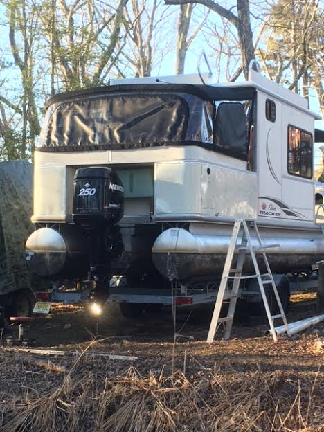

im hitting 5600 rpms at WOT wich is perfect and never hitting rev limiter, with a 2 stroke if you don't have it propped correctly you risk premature engine wear. when I finish welding the strakes on I might have to change props again, this boat is 32 feet long and heavy not aerodynamic at all. we can cruise at 20 mph and we no longer get passed by every dam boat on the bay and have to eat their wake.

what does the light in the prop do? mine doesn't have one.
Re: prop help
[quote="boocat"]what does the light in the prop do? mine doesn't have one.[/quote]
