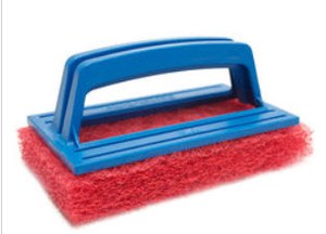

I tried 3 of the 3M Scotch Brite Hand Scrubbers that some of the marine part stores sell and the medium was the best for me. The coarse scratched the toon and the fine really did not do anything on the rough stuff. Since my toon is in the water May - November, I do a light scrub every week and pull it out about once a month to do a better job.
medium PN 01009 - red pad
coarse PN 01008 - black pad
fine PN 01010 - White pad
