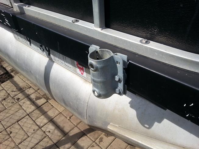

Hey guys, wanted to get your idea's on something. We primarily use our pontoon boat for fishing.. normally when we get to our fishing spot we just tie the front end of the boat to a tree branch and then I usually throw out an anchor or two on the back end, depending on the wind. Well anyway I have been thinking about going with one of these "push rod anchor systems"... you've seen them I'm sure... It's a pole that you can get in various lengths, usually has a metal tip on one end and a handle on the other... most of the companies make a bracket you run the pole thru so that you can push it into the lake bottom to hole your boat.. problem is these systems are fairly expensive, 200 to 300 bucks or more per system, and I want two, one for the front and one for the rear... anyway I'm pretty sure I can make the pole myself - probably buy 8 to 10 feet sections of 1/2" pvc pipe, put a T on the end for a handle.. but I'll need to find something to put as a point on the other end... also I need a way to mount a cheap bracket to run the poll thru.. I was thinking about buying a couple of cheap rod holders like the one pictured below, and just mounting them with screws thru the rub rail. Any of you guys using a "poor mans' power pole system.. if so what did you use -- what do you think about my idea for a home made pole and rod holder.. any reasons why it would'nt work? Thanks

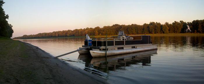

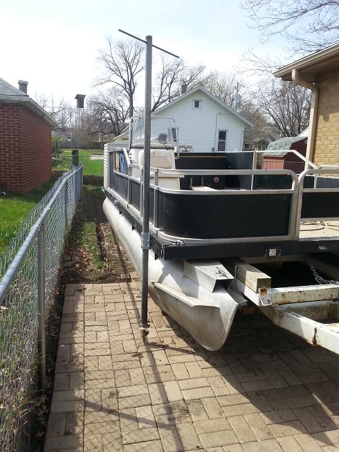

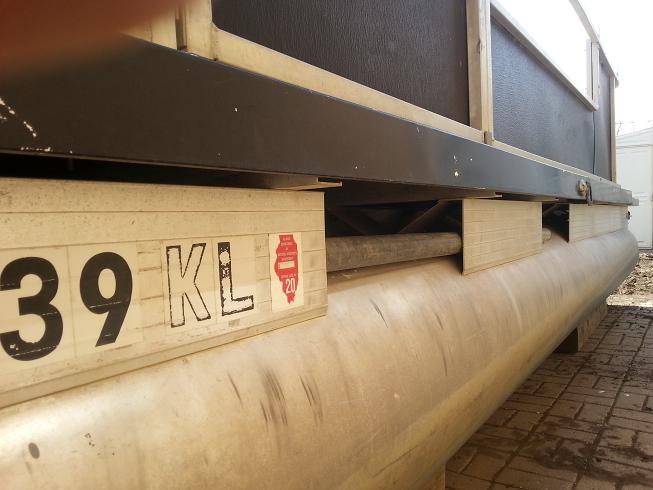

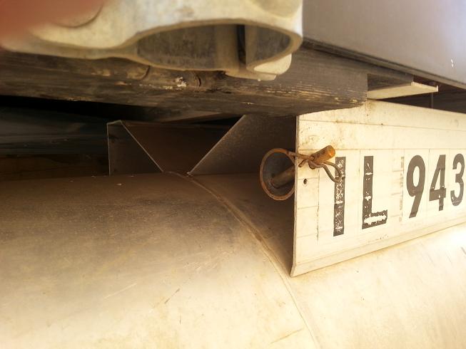

You said poor not pretty. Been using this for the last six years. I needed something that would hold up to the current when a barge goes by and the wake of a large cabin cruiser. I just used floating dock parts from Menards. Everything is mounted to a 4x4 bolted to the deck and frame.

#6 Post by curtiscapk » Wed Apr 25, 2018 11:16 am
FREAKIN INGENIOUS!!!!!!!!!!!! LOVE THIS PLACE!!!!!! Maybe 50 bucks for that setup?????????
mgarvie
Posts: 187
Location: Pekin, IL
Re: Poor man's power pole
#7 Post by mgarvie » Wed Apr 25, 2018 3:02 pm
Right around that price. Plus the poles store on top of the logs held in place by the hardware that holds the screw on.

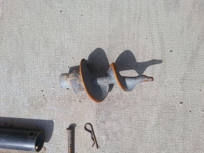

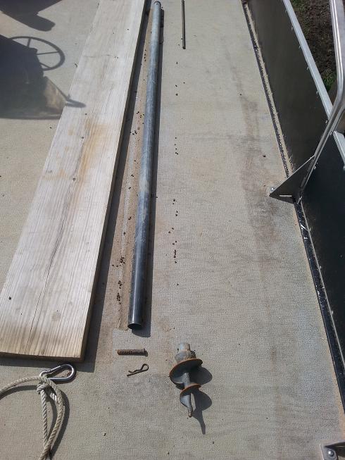

Have you considered threaded black pipe for home gas lines? Get the lengths that will fit in the space you have to store it. Heat and pound the first one to a point to go into the bottom sand/mud. Then just screw sections together till you have enough to reach the depth you need.
