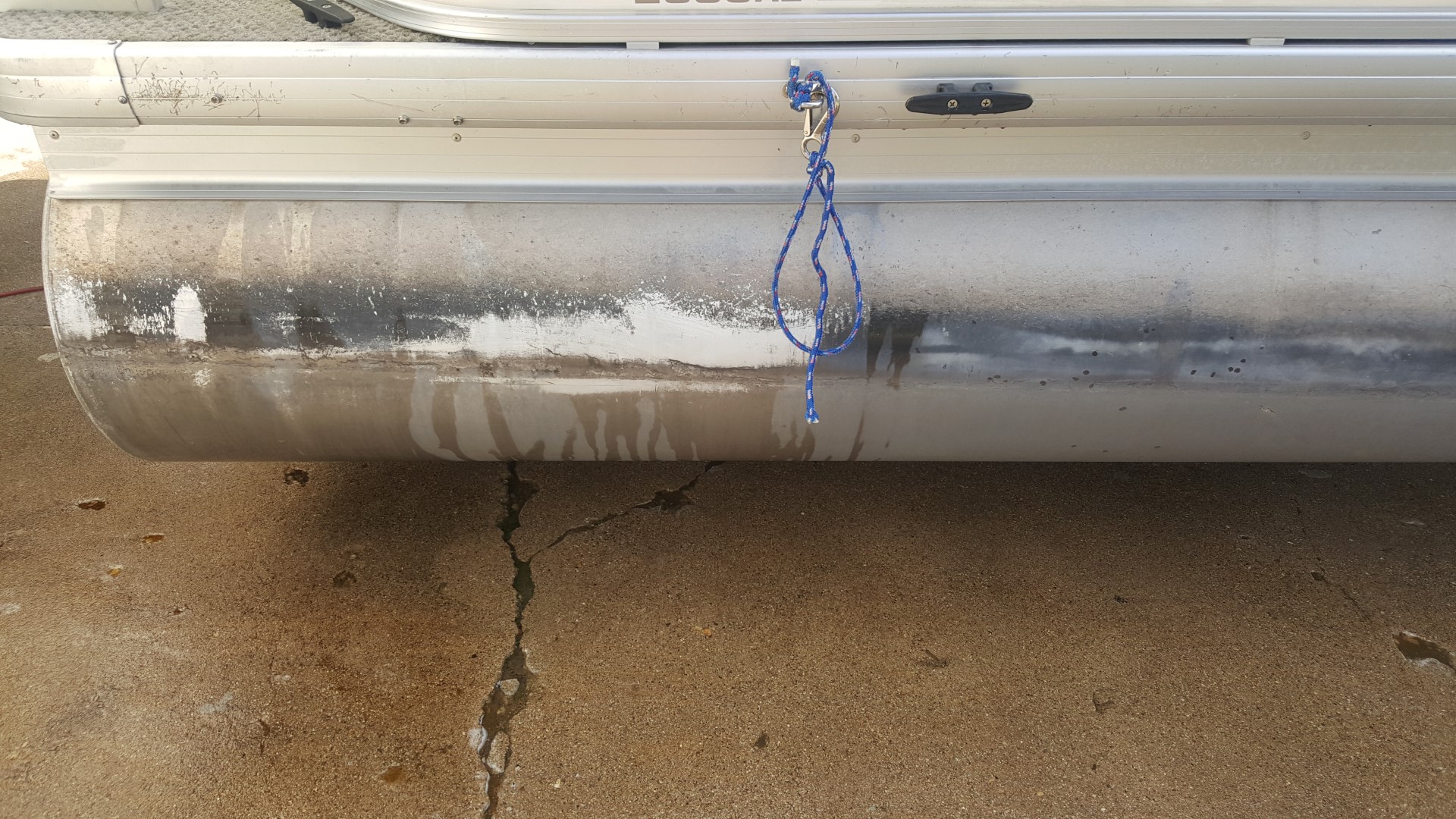

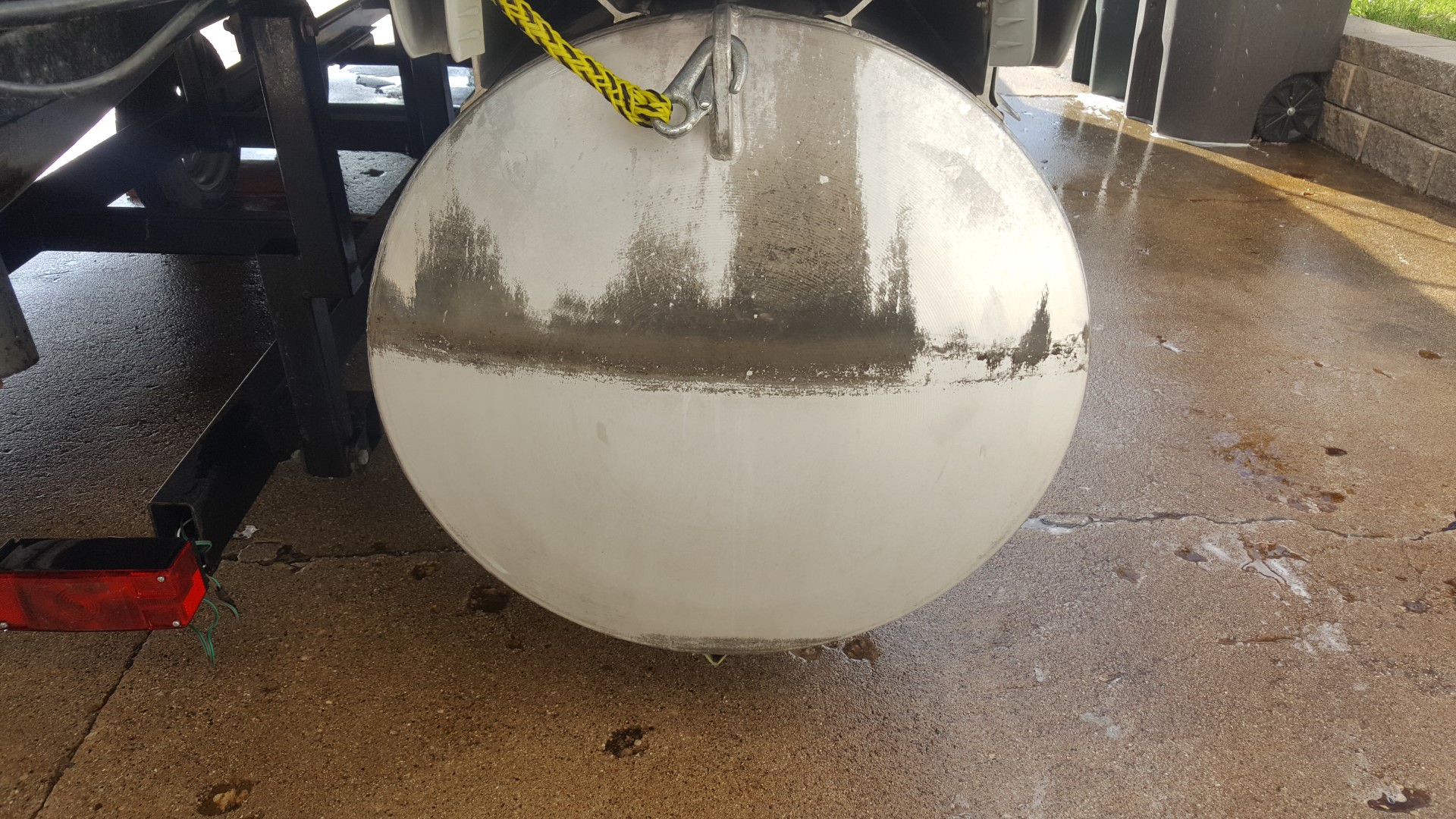

Just picked up my Sweetwater pontoon from storage and dropped it in the driveway of my lake house. I need to fix a few things, change fluids and of course clean it. I have an electric pressure washer and cleaned off the right tube pretty thoroughly and then sprayed "JJV's Best ALU100-G Aluminum Pontoon Cleaner" on it https://www.amazon.com/gp/product/B00FP ... UTF8&psc=1
I did the back of the tube repeatedly and the area below the water line looks great(who cares), but above it's all blotchy. I sprayed it on heavily, waited a few minutes, added more and scrubbed with a large scotchbrite and or brush, waited a few and pressure washed it off. It the side view picture I did the area left of the rope. Any ideas how to make it better? It's dead smooth on the sides. My friend said get a gallon on muratic acid?

Could that be oil residue from a slick floating by. I don’t think the alumabrite stuff will cut oil. Try first with a strong detergent like a tire cleaner to remove the oil first. Then apply the brighter. Good luck and let us know the outcome.

If you use muriatic acid, don’t go beyond a 40% solution mixed with water.
My neighbor, who does a lot of aluminum boat work, recommends a 20% solution, which will probably take two cleanings.
He says that anything around 50% and up will turn the aluminum white. That won’t hurt it, but likely isn’t the look you’re going for.

Just go to NAPA and get a gallon of their aluminum cleaner. It is an acid based product but safe if used as directed. It is cheaper than the stuff mentioned bought on Amazon. HVAC outside condenser coil cleaners are essentially the same product.

My toons looked about like your, if not worse. I used the NAPA product and could be more pleased!! Just sprayed it on and hosed it off after 30-60 seconds. One gallon did my entire pontoon (2 tubes) and ladder and some of the trailer that had stains from trees. Will absolutely use it again when needed. Some good stuff for very reasonable price. Easiest cleaning I have ever done on my toon!

I went to Napa bought a gallon of aluminum brightener for $18. That with a scotchbrite and my electric pressure washer did the trick. Thank you. I forgot to take after pictures and now it is the water. And it's cold and rainy...
