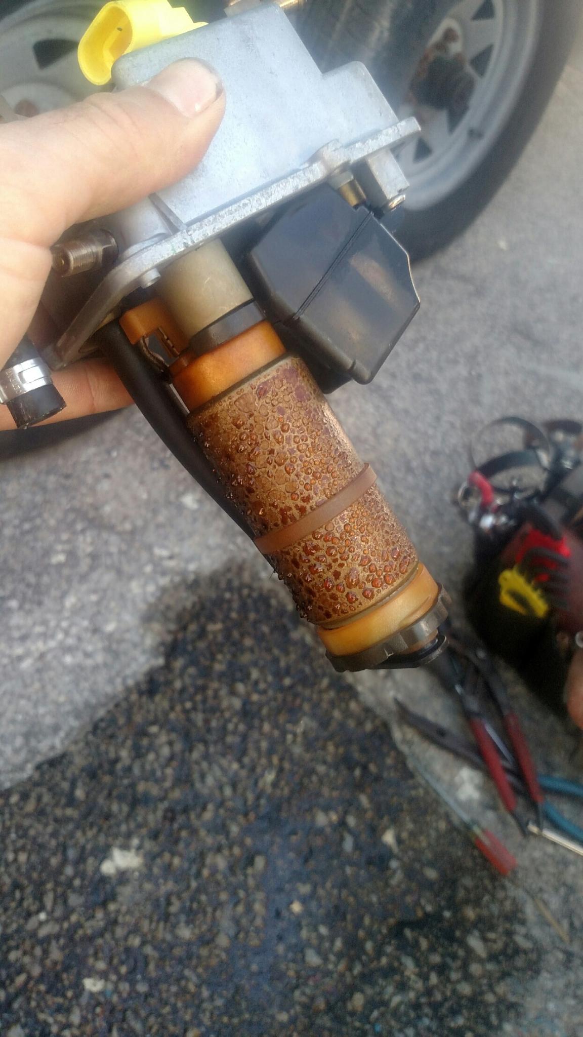

I know lots of folks who still run ethanol, I gave it up 6 years ago in anything but my daily driver vehicles. I have seen so much destruction of fuel system components in outboard motors, even with after market additives. My advise to everyone is if you can get non-ethanol gas: https://www.pure-gas.org/ use it for your boats and yard equipment, it will virtually eliminate your fuel issues. Here is your Mercury VST Fuel pump after sitting with ethanol in the VST. Locked up solid, wouldn't even run from the corrosion damage.
vst pump.jpg (234.98 KiB) Viewed 5177 times
