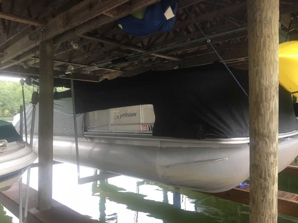

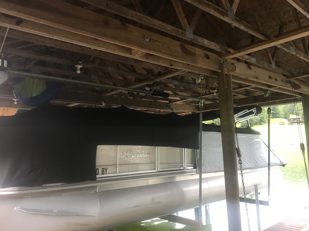

I too didn't like the idea of our boat hanging out of the covered boat slip by a foot or so, plus the engine..... SO I made a homemade skirt that keeps the paint, vinyl decking, hoses, etc from the elements.
I hand sewed the silver ( tarp ) to fit exactly all the way around the back half of the boat. I used Gypsy snaps on it, so the SKIRT snaps onto the factory boat top snaps, then the factory boat cover snaps over top of the skirt. It folds underneath the deck and I put snaps onto each of the frame members so it snaps all the way around both sides, and starts across the stern. Where it goes around the ski tow, I put a slit in it and then 3 pieces of velcro. Over the swim ladder, it's all sewed to fit. Across the stern, it is weighed down by 4 sewed on sand bags. 2 on each side of the engine. That way, I can do this all from the dock finger piers.

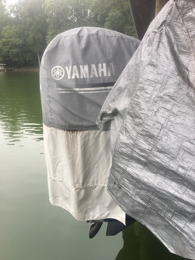

I bought a standard Yamaha engine cover but didn't like the idea that it only covered the top, so I took more Sunbrella fabric and sewed it onto the top so it's covered on 3 sides. It's out of the elements for the morning sun, etc. Total cost for both the skirt project, and the engine cover extension was less than $100. SURE wish I owned a sewing machine !!!!!

Very cool design. Well done!

Very nice work Strake!
