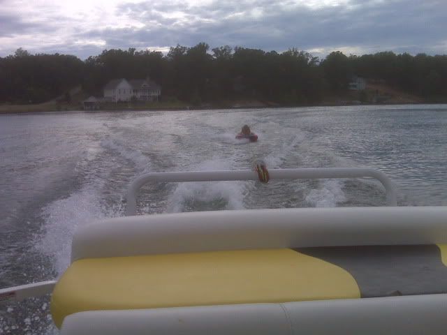

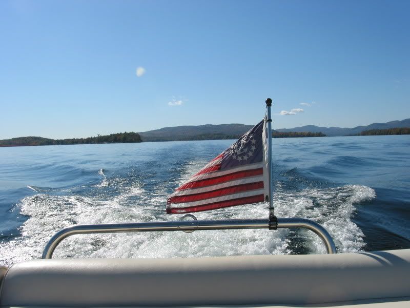

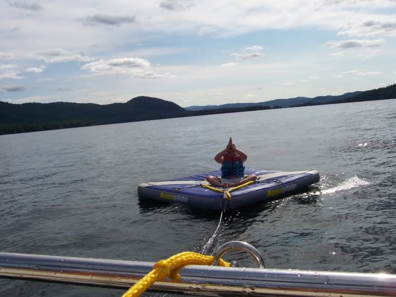

Those are called ski tow's. Most look something like this
http://columbia.craigslist.org/boa/1267146898.html
The rope mounts in the center, since it is higher it will help keep the rope out of the water. Less a ski tow, next option would be cleat or grommet in the log. I always attached to the log. Most manufacturers have the ski tows as an option or can be purchased later, think there may be a few aftermarket one out there to.

We have a ski tow bar on ours, we like how it holds the rope up out of the water some, on our other pontoon the rope hooked to ubolts down by the deck.
