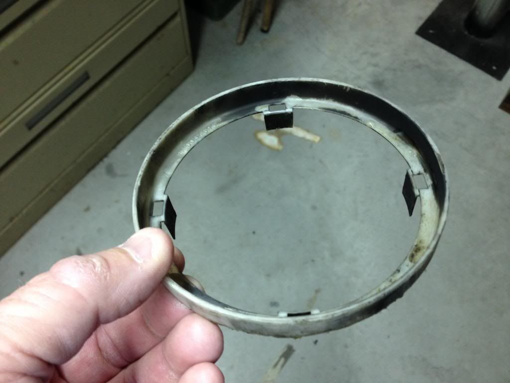

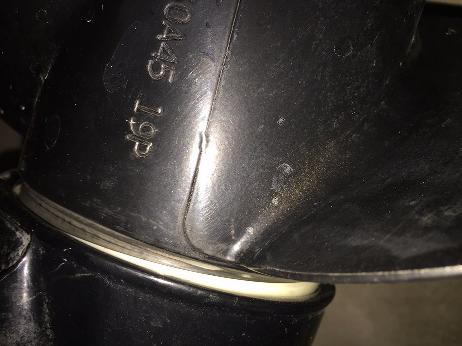

Junior, I'm a little late to the party, but the fix for your issue should be a new Propellor bore sleeve. Some people call it a blow out ring. It a white plastic ring that snaps into the lower unit right in front of the prop.
https://www.crowleymarine.com/parts/759949.cfm
