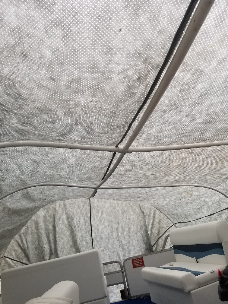

So here is a quick pic of the inside of the cover, the pvc has started to bow so I might have to make some changes, maybe add some supports that sit on the deck.
And here is how I attached the pvc. I used 1" pvc and attached it to the fence. The 1/2" PVC just slips into the 1" PVC and is easily removed. I'll probably make a new version, something more sturdy, but since this was the first attempt I don't think it turned out bad.

i'm switching over to 1/2" metal conduit so I don't have the issue of the pipes bending. I think with the weight of the cover plus the width of the pontoon the PVC was just not rigid enough to hold up. I think the metal conduit will be better. I will update once I get it changed out.

ok...so here is take 2! I replaced the pvc poles since they couldn't hold up, they just started bending under the weight, so I used 1/2" metal conduit and bent the pipe to how I needed it.
The conduit came in 10' long pieces and I kept them that long so that the cover doesn't touch the ground anymore.
I also added another set of brackets to the side to give the conduit more support. so far much better. still some tweaking needs to be done but overall a better system.

Looks like that will work! I was wondering about PVC sag when it rains.
