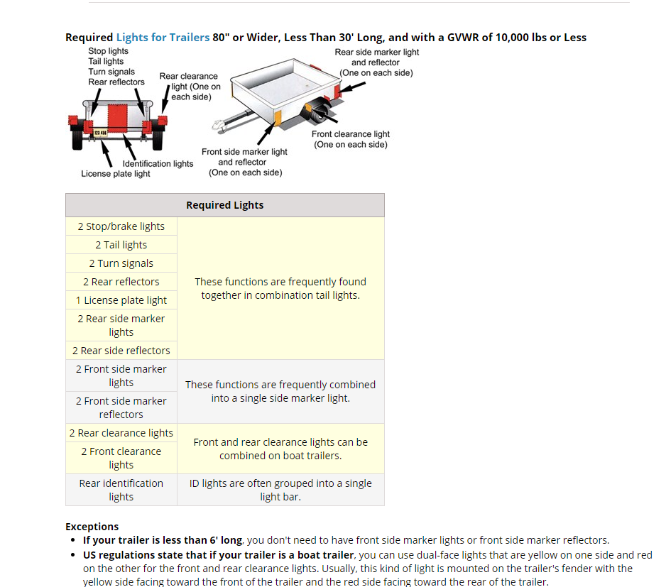

Hi everyone! So I am going over my trailer lighting requirements here in Florida and based on what I have read I should have it set up like this:

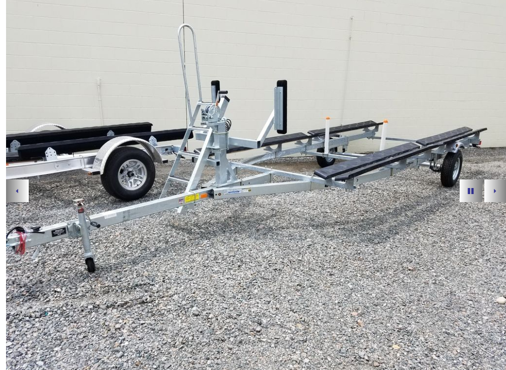

now my trailer looks somewhat like this one minus the fenders over the wheels:
So I don't have a place to put clearance lights on the fenders...since I don't have fenders, is that gonna matter?
I was gonna add some reflective tape and side markers up closer to the front of the trailer.
Any other suggestions? I already have the typical stop, turn, and parking lights on the back.

I like to use reflective (red/white) tapes along the sides. Don’t forget to place one on each side waay up front near the hitch to allow someone to realize that, when it’s parked in the dark, they need to pas well in-front of the tongue. (Place the white in a forward pointing and the red toward the rear.)
Also, go ahead and buy quality tapes from RV/Trailer stores...avoid the Horrible-Fright cheapies... they fade from sunlight exposure pretty quickly and lose their reflectivity, then they’re hard to remove due to becoming brittle and hard.

Buy sealed LED tail lights. Almost all come with the side rear marker light as one piece.
As far as the front side markers, yellow, mine seem to always be going out for some odd reason. Just cheap I guess. My rears seam to last forever.
the center rear led light seems to last forever also.
I have NEVER been pulled over for side markers, only non functioning rear lights......
however, if a day on the water includes beverages, do not drive home with any lights not working....

I got some guide guide posts for the trailer and the plan is to put a set of sealed led tail lights on it so it's far away from the water. I did get some smaller amber and red lights that I will put on the tube for the clearance lights and put a couple more amber lights on the trailer farther up. I also have the 3 light lightbar that trailers over 80" are to have. I hope to get it all wired up this weekend.
