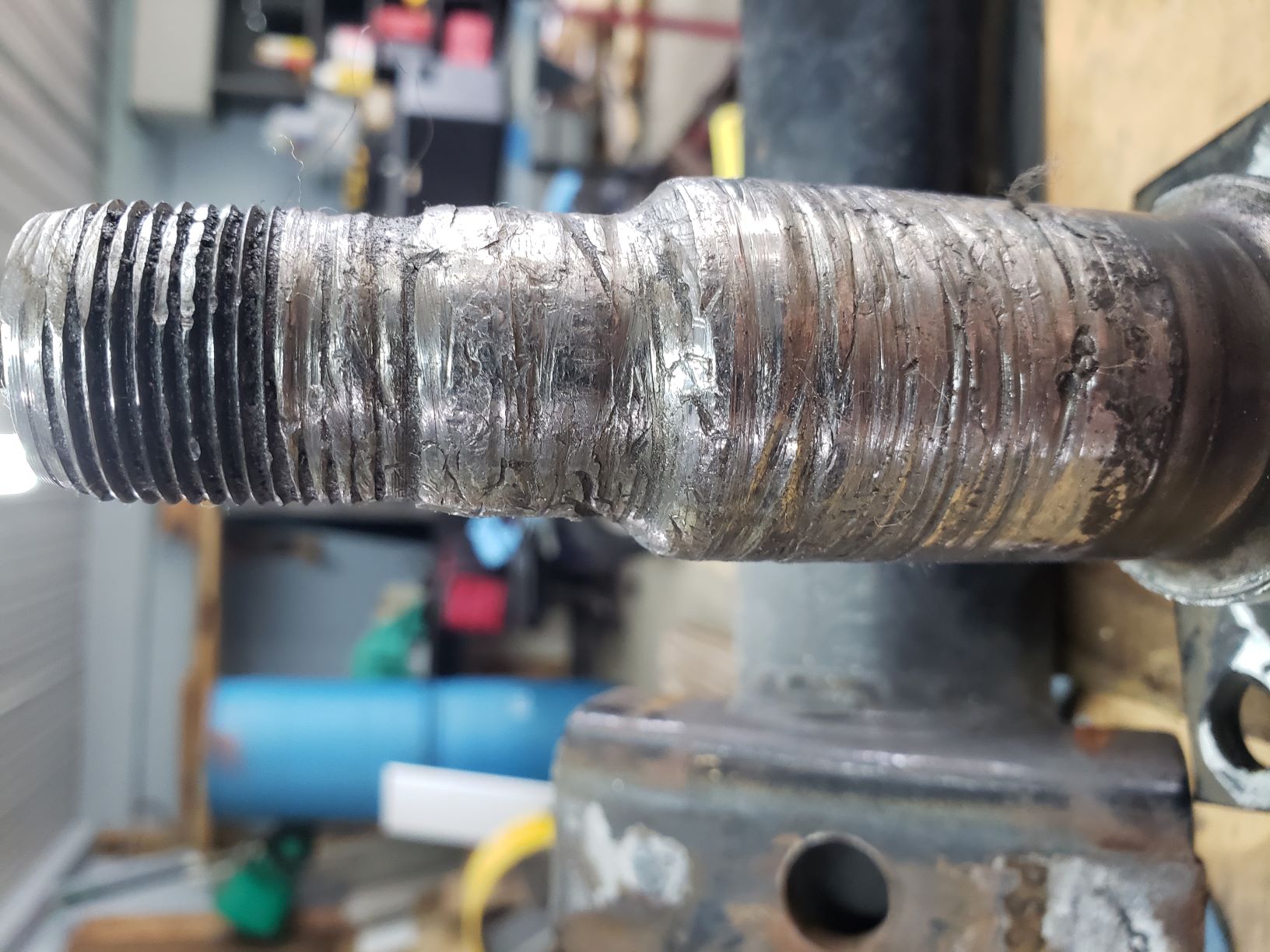

Heres the update. Spindle is destroyed. Hub is destroyed as well. I will be welding a new spindle in when it arrives. On the advice of a trusted big trailer and truck axle service shop, I will be replacing the bearings with ONLY AMERICAN made products. (timken bearings). He says that all chinese bearings are scrap metal in his view, as he has seen numerous failures from newer equiptment, and this dude does it for a living. He also said that my Dexter EZ lube axles come from the factory with foreign bearings now, since about '95.... Now it is a significant increase in cost, but with a 26 foot pontoon on 10" wheels and a tandem trailer, I'll gladly pay the price up front for good bearings, versus the bigger expense of replacing axle parts and risking a roadside breakdown. I'll be a little under 400 bucks on this repair with me doing all the labor.

fiddlebick wrote:
Mon May 18, 2020 8:54 am
Heres the update. Spindle is destroyed. Hub is destroyed as well. I will be welding a new spindle in when it arrives. On the advice of a trusted big trailer and truck axle service shop, I will be replacing the bearings with ONLY AMERICAN made products. (timken bearings). He says that all chinese bearings are scrap metal in his view, as he has seen numerous failures from newer equiptment, and this dude does it for a living. He also said that my Dexter EZ lube axles come from the factory with foreign bearings now, since about '95.... Now it is a significant increase in cost, but with a 26 foot pontoon on 10" wheels and a tandem trailer, I'll gladly pay the price up front for good bearings, versus the bigger expense of replacing axle parts and risking a roadside breakdown. I'll be a little under 400 bucks on this repair with me doing all the labor. spindle damage.jpg
That is a good job bearing failure, looks like mine from about 3 years ago coming back from the river Yuma AZ. Had the pontoon/trailer on a flatbed tow truck and the whole thing fit on by 3/4 inches. Now I check those more frequently and replace, particular running the boat in salt water.
