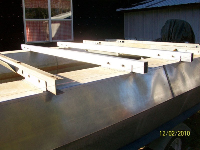

I have 90 model hex toon with no dents or dings the bends increase strenth it even planes out with a fourty hp. A flat bottom being the best plaining design over round or v bottom. Why no one else builds these - Can you say patent. As for there being more welds only one longitudenal seam so thats the same as round and one less than u shape add to that the reinforcement of the weld not being ground off in both the longitudenal and section weld more strenth and less chance of leaking. :box

Well that looks pretty cool.
I've never seen such a thing. :coffee

Less welds than any other type and the weld reinforcement is not ground off leaving a stronger finished product :smoke
