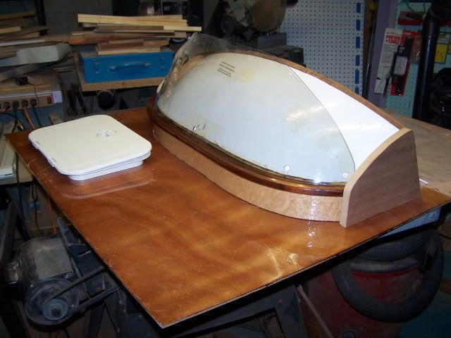

Here's mine. Might be a bit fancier than you're thinking about!
I have room underneath for a 5-day cooler, miscellaneous "lunch" objects, the stereo receiver and the wiring connections.
Good Luck with your console project.

Re: DIY wood consol
Yeah but you don't have the foot warming furry foot rest
That is a pretty console.

Re: DIY wood consol
Wow, that's truly a work of art... more pictures please!

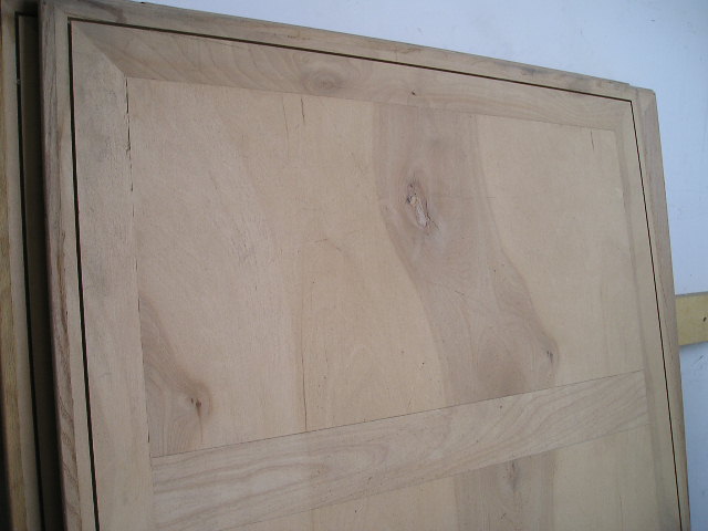

I had a chance to get over to my buddies to get a look see at the wood he was donating.
Wow 4 sheets of 36"x 72"x 1/2 white oak

Re: DIY wood consol
Thanks for the compliments on my console and wiring. My brother gets all the credit for the wiring. He does marine electrical and electronic installations as his business.
Ron, I have many pictures on ths site under the Member's Photos forum. Look for "Wooden Pontoon Progress" or something like that.RonKMiller wrote:Wow, that's truly a work of art... more pictures please!
