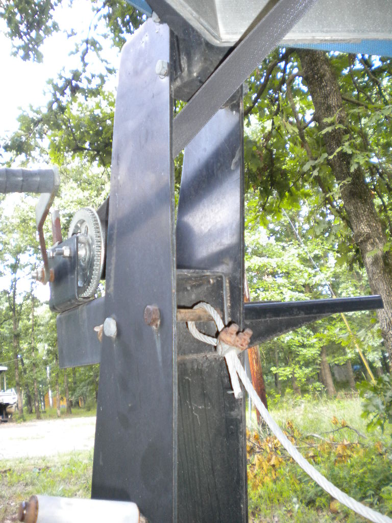

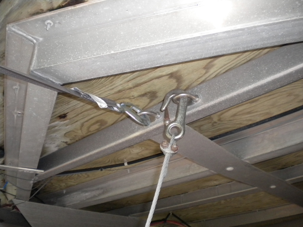

This is what I did.

Re: Bow Eye Location
#14 Post by lakerunner » Sun Feb 20, 2011 8:32 am
UMMMMM what did you did?????
GregF
Posts: 3323
Location: Estero Florida
#15 Post by GregF » Sun Feb 20, 2011 10:41 am
The first time I pulled my boat out I bent the Z stringer so I got 4 stringers on this bracket and 4 bolts go through the deck.
We used to have a horrible ramp here and you were pretty much winching the boat all the way.
1974 Harris
