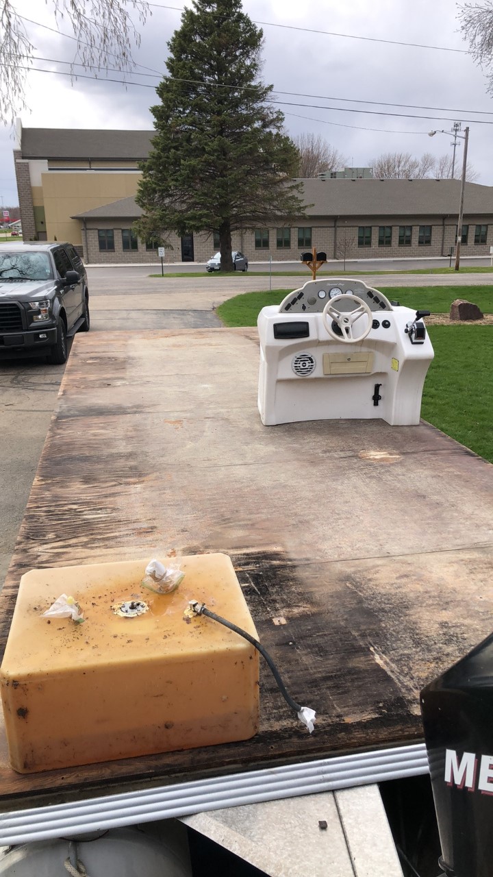

made some progress today
and how much of this has to come off?

#22 Post by TWB » Wed Apr 21, 2021 5:20 am
wiread wrote:
Tue Apr 20, 2021 3:04 pm
Looking good! The nice thing is once you get this completed, everything starts going up not down.
Personally, depending on what flooring you're using (I don't remember, and I'm too lazy to read back now!), you might feel little bumps under it. It looks like you could probably sand off anything you can feel with a hand rub. Think Princess and the Pea.

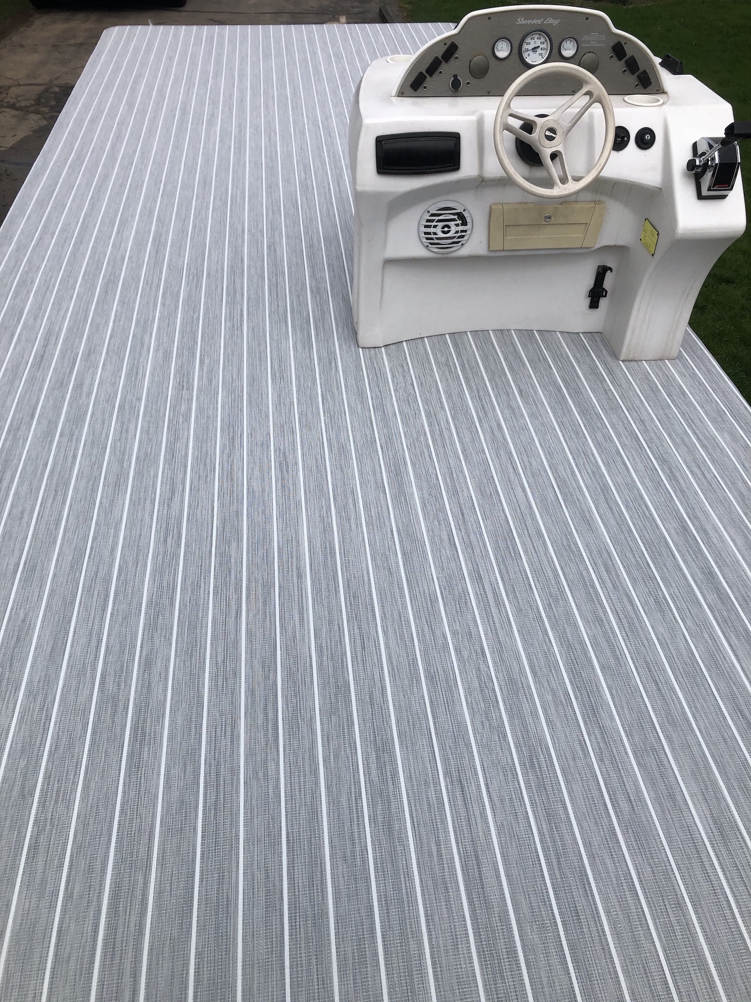

#25 Post by wiread » Tue May 04, 2021 10:14 am
man, flooring was supposed to be here, then not, then pushed back and then there it was at my door Saturday morning. Of course Saturday would have been a great day to put it on, but plans were already made with Great Grandma and the newest great grand baby. Sunday was supposed to be 60 and rain again for the next 10 days basically. so I pushed it off.
Then I woke up Sunday and it was nice out, checked the weather and it was sun and 70's. Called my dad and said, "want to come over". Ended up being sun and mid 80's. Rain was in the forecast and 50's that evening so we quick put it down and tarp'd it well. I stuck some electric heaters underneath to keep temp up overnight. was 110 under that tarp for about 7 hours until it cooled and rained. The heaters kept it 70-72 under the pontoon all night and kept them on until 7 the next evening so glue had plenty of curing time.
went pretty well.
new floor.jpg (1.42 MiB) Viewed 265925 times
Re: General question on timeline
#26 Post by ROLAND » Wed May 05, 2021 12:30 am
wow, it's looking GREAT. Love that flooring... You'll have her lake ready in no time. Keep the pics coming.
