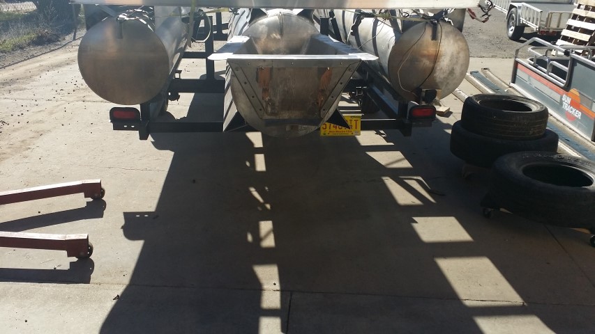

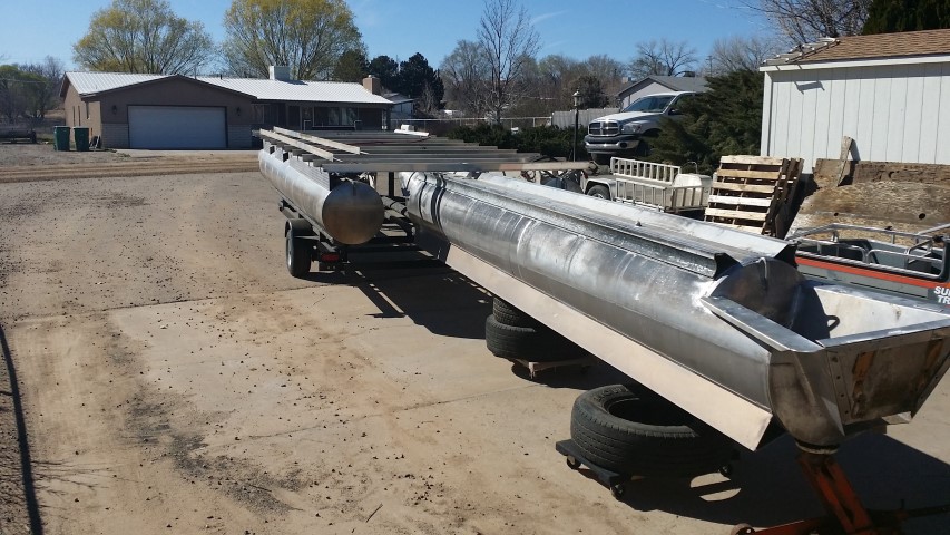

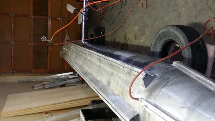

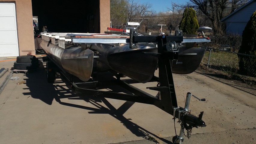

I spent Saturday looking for pin holes in the welds (think I poisoned myself with fumes). Had a fancy pressure gauge (thanks grandpa), to double check. I got all the pin holes on the outside, unfortunately I found two that are only leaking on the inside of the strake...trying to figure out a solution to that.

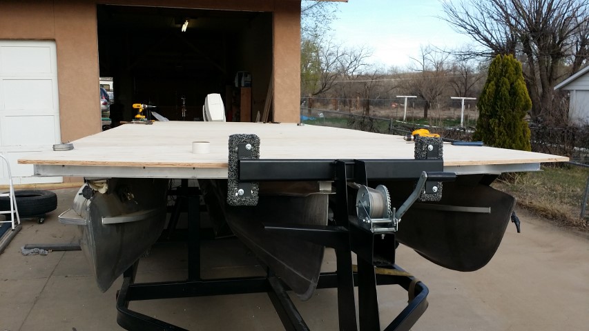

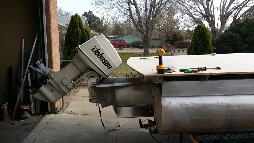

Anyhow, being frustrated with the two hard to get to pin holes (very small, I lost 2/10 of one pound of air in 3 hours). I decided to move forward. Here what it looks like for one person to install a center tube.
Here she is, installed for the last time (hopefully)
and from the front

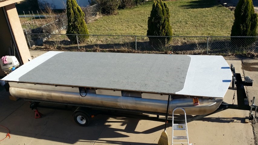

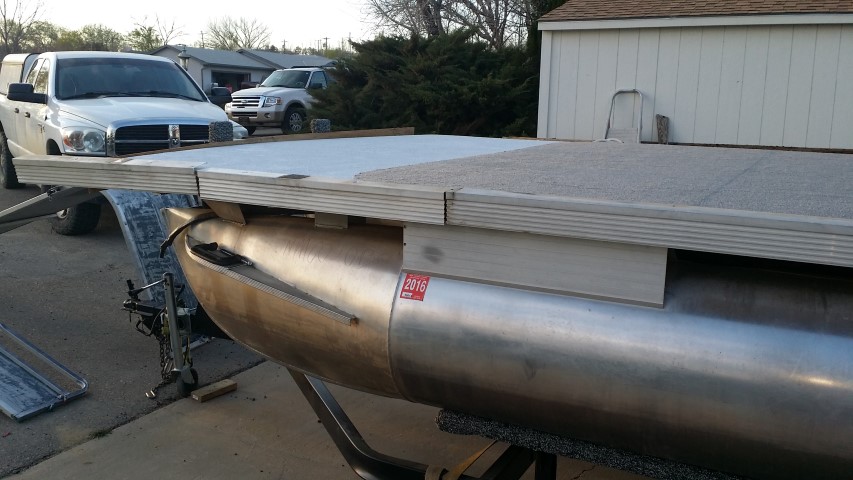

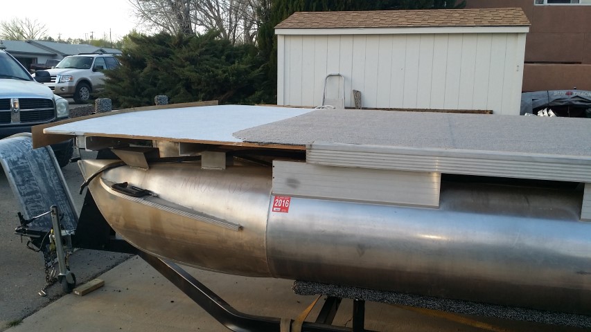

Weekends seems to go too fast, so no time to waste. The deck went on!
- 2015-03-21 16.04.22.jpg (175.16 KiB) Viewed 15379 times

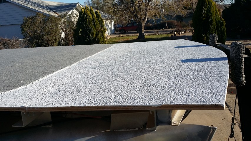

Quick update from the weekend. Family was a huge help this last weekend. They pitched in and helped me get the floor on. I am going with carpet inside the playpen, and using kiwigrip (rhino-lining type stuff) on the front (3.5 feet) and back (2 feet).
my plan by the end of this last weekend was to have the floor on, rub rails on, and the playpen panel primed. I got the floor on and ran into a big snag on the rub rail. I did not have enough!
Not enough in a single piece. But, like Toonguy said the front of the bassbuggies are weird (look at first couple pictures). I tore apart the weird parts and was able to piece together enough to make it work.

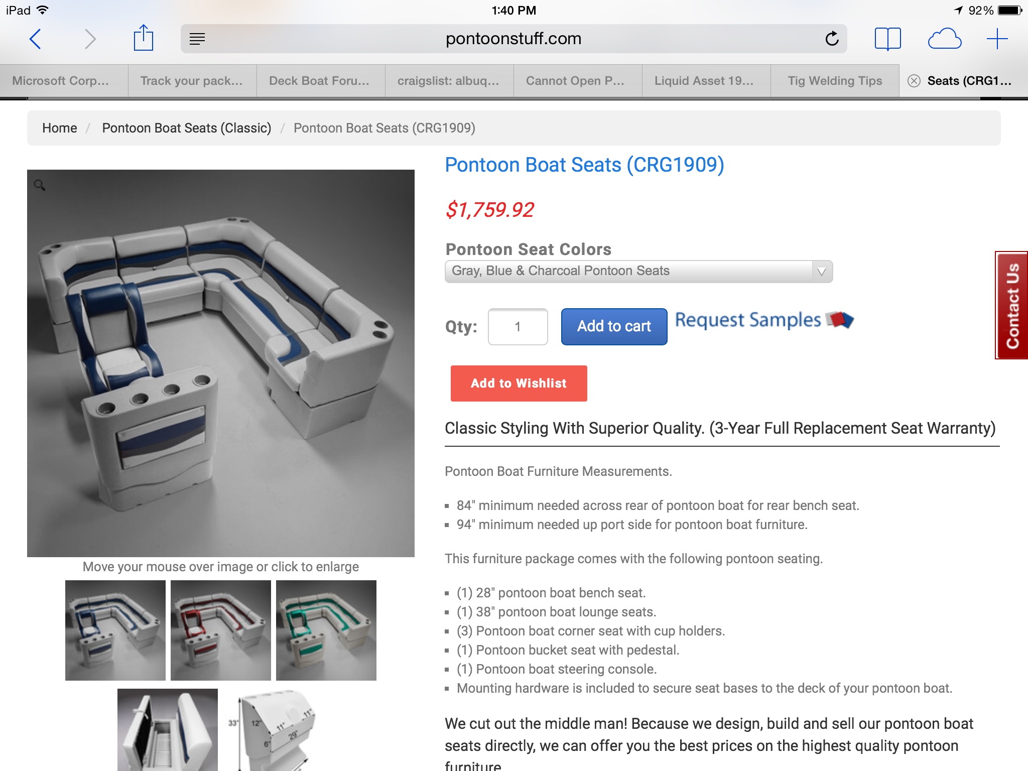

When I look at their site it shows the grey blue on BO till 5-1 unless they changed it after your order????
Re: 1988 Bass Buggy winter/Gravity project in New Mexico
I am still not seeing it. Can you post a screenshot of where your looking? Not that it matters, I am just curious where my ignorance has reinforced my lack of planning. Here is what I ordered...from an ipad
Just so we are clear I am not upset at pontoonstuff.com, they have done their job great. I am disappointed in myself for waiting to order at the last minute

AAAAH. I looked at the single seats not the groups! My bad. Check your PM.
