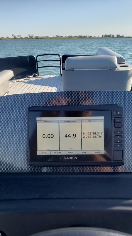

Got some time to play on the lake today for a few hours. We tried a couple of different props my buddy loaned me.
So we tried a Stainless 14 x 21p 3 blade and saw 37mph gps @ 5600rpm...if I tried to trim up the prop would let go. So we swapped that out for a Mercury Mirage Plus, which is a 14-3/4 x 21p 3 blade. Top speed was 44.9mph! :thumbsup Unfortunately my WOT RPM dropped to 5100-5200rpm. I think I need to raise the motor a bolt hole, I can't see the cavitation plate when running. This engine is a tad heavier than the 90hp Johnson :biggrin2
Hopefully with a few more props to try out and engine height adjustments I can get her to run a few more MPH's into the upper 40's with this 200hp Mercury!

Ok fellow Tooners...Here is the pic of my ALMOST 45 MPH! :alright Going to play with more props and motor height. Probably only get one maybe two more trips out. It's time to wrap up boating in Michigan.
44.9mph GPS.jpg (129.75 KiB) Viewed 198841 times
