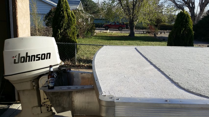

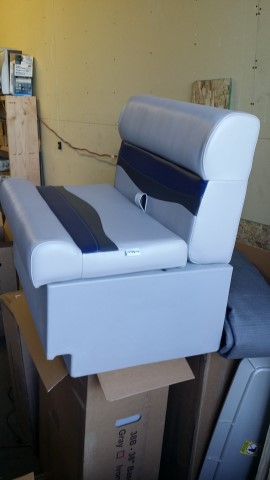

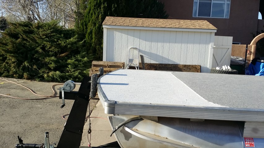

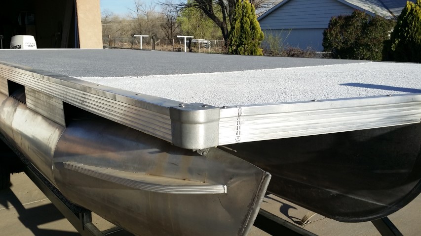

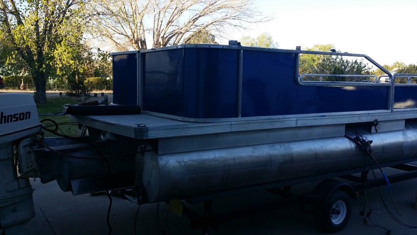

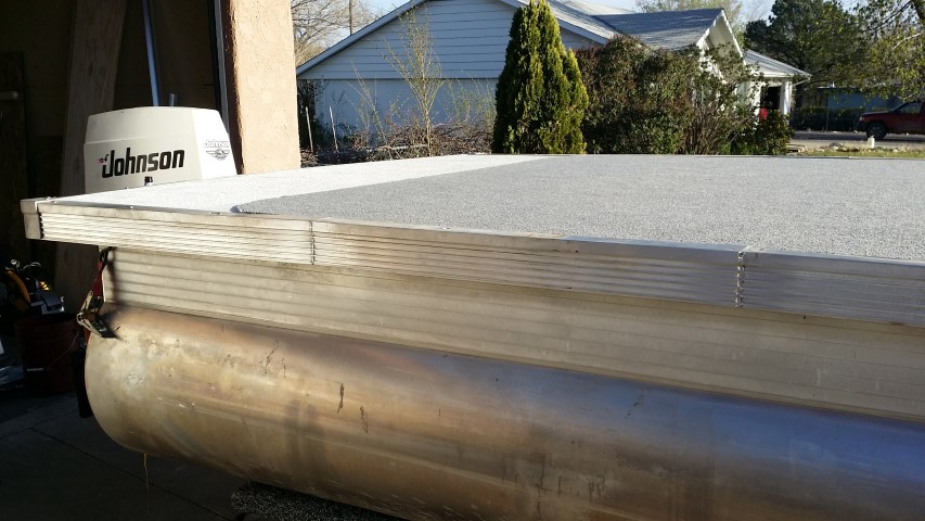

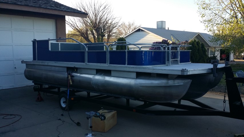

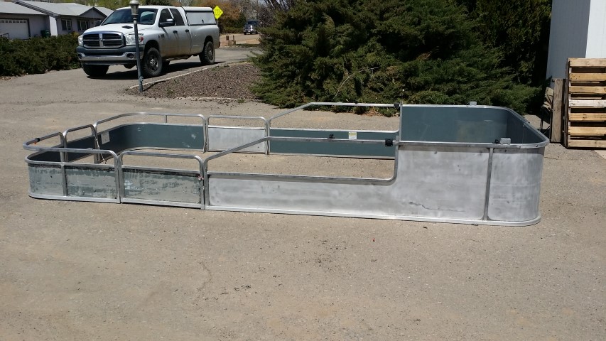

I did not get a lot done this last weekend. The rub rail is on, and a few other miscellaneous items. I received the bulk of my furniture. I started to lay all that out to get an idea of space. I took the play pen panels down to the paint shop. For the next few weeks most of the progress is going to be "hidden" stuff (wiring for console, moving batteries and fuel tank, etc.). Here are a few pictures of where I am.
2015-04-01 13.10.15.jpg (154.62 KiB) Viewed 14948 times
Rub rail is on
2015-04-03 18.17.04.jpg (161.75 KiB) Viewed 14945 times
close up of spliced in front piece
2015-04-03 18.17.13.jpg (140.45 KiB) Viewed 14946 times
picture of the spliced in side pieces
2015-04-03 18.17.27.jpg (137.1 KiB) Viewed 14945 times
I used Toonguys suggestion to cut the rub rail down, to bend it around the radius at the front and back. Came out pretty good

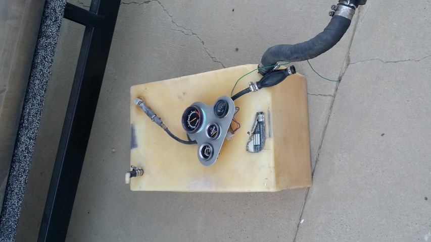

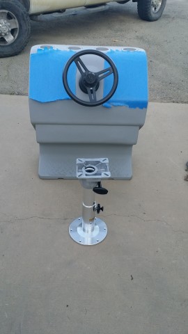

Rounded up an 18 gal tank
2015-04-14 07.30.43.jpg (103.91 KiB) Viewed 14850 times

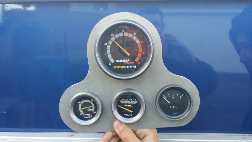

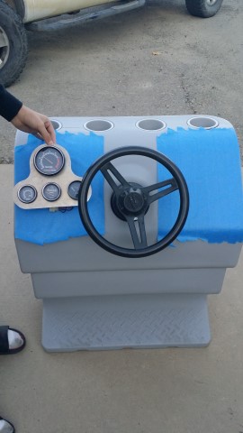

robbed the fuel gauge as well. I did not want to mount the gauges directly to the console so I whipped out a bezel.
2015-04-14 07.30.21.jpg (89.12 KiB) Viewed 14845 times
Console with old steering wheel (I re-used a lot of old parts, that way when I get bored I have upgrades to make later :happy )

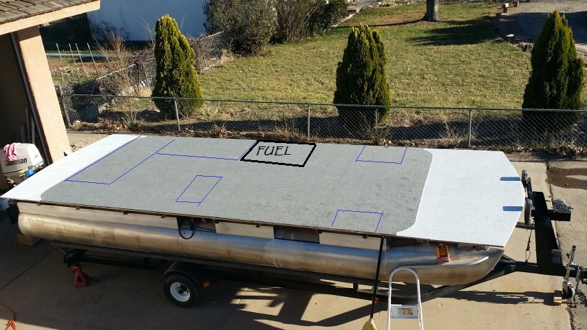

Here is a question. With this new to me tank, will I have any problems mounting it "mid-ship"? Here is a diagram of where I am wanting to put the tank.

is that going inside a seat base? If so I would vent it and you should be good I would think. I will let others chime in who have done it. Mine is under my sundeck.

The tank came out of a bass boat. I will build a box for it to live in and vent it right out the side...possibly cut some vent holes in its cage as well. The only issue I can come up with, is the length of the fuel line. Will the engine fuel pump have enough "pump" to suck the fuel?

Ercarp wrote:The tank came out of a bass boat. I will build a box for it to live in and vent it right out the side...possibly cut some vent holes in its cage as well. The only issue I can come up with, is the length of the fuel line. Will the engine fuel pump have enough "pump" to suck the fuel?
It will be fine :thumbsup
The motor should run with out a pump with the tank on the deck and the low profile of the jonson , once primed with a full tank fuel should siphon to the motor .

that is great to hear, thanks for the feedback curtiscapk, toonguy and hawk. I was concerned about that.
