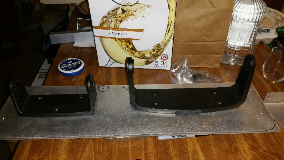

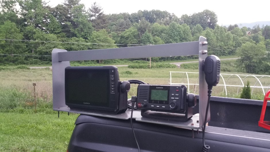

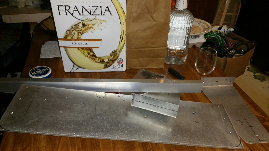

So factory pontoon parts are not really made for electronics, I bought electronics before a boat :mrgreen: so what to do with the stuff :donno
It sits at a marina and when the electronics double the value of the boat...the tweakers and meth heads come down out of the hollars and feed...their addiction buy; stealing good hard working peoples shit :x
So I did some measuring and sat in boat in the back yard making vroom vroom noises and pushing fake buttons
My plan:
I can build her box :P . I have the technology. I can make her better than she is. Better, stronger, faster.
so I cut some alum out and mocked up what needed to be cut and rounded and bent (no way to weld alum. at home yet...so I made an erector set)
2018-05-28 15.11.01.jpg (153.17 KiB) Viewed 41031 times
2018-05-28 15.10.25.jpg (129.33 KiB) Viewed 41031 times
painting
2018-05-28 15.08.50.jpg (217.39 KiB) Viewed 41031 times
start to assemble
2018-05-28 15.09.28.jpg (148.06 KiB) Viewed 41031 times
I used 2" long 10-32 SHCS to bolt sides to bottom and to be used as locators (need to swap for SS bolts)

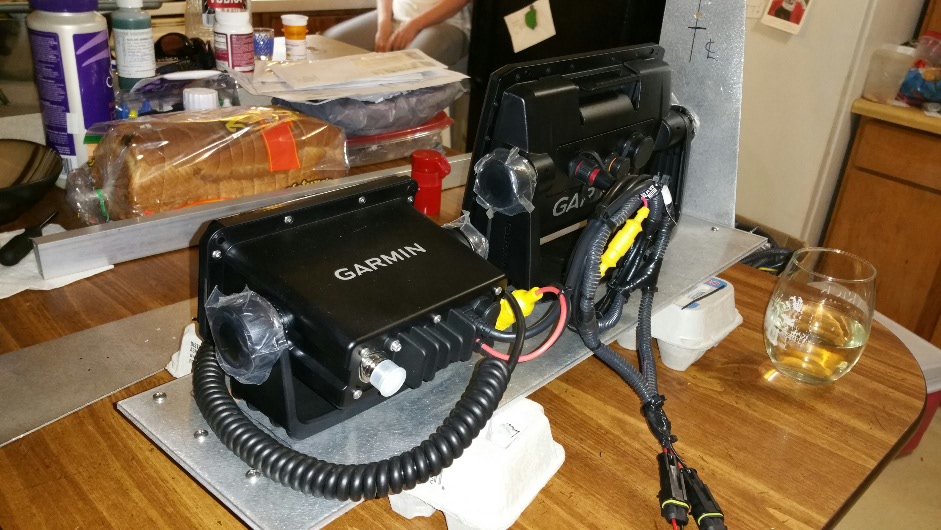

wires tied up and secured with quick disconnect plugs
2018-05-31 18.57.31.jpg (162.69 KiB) Viewed 41031 times

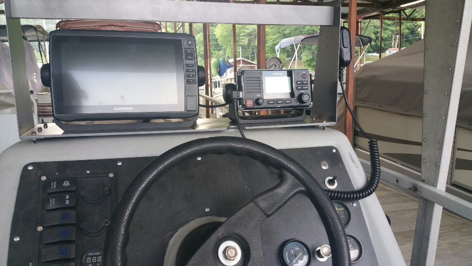

Here it is looking like an old skool tool box, I used 2 pc of 1/4-20 all thread thru a pc of 2.0 x 1.0 x 1/8 wall x 24 inch long rectangular tubing for the handle/roll bar :drink2
2018-05-30 20.01.57.jpg (167.1 KiB) Viewed 41030 times

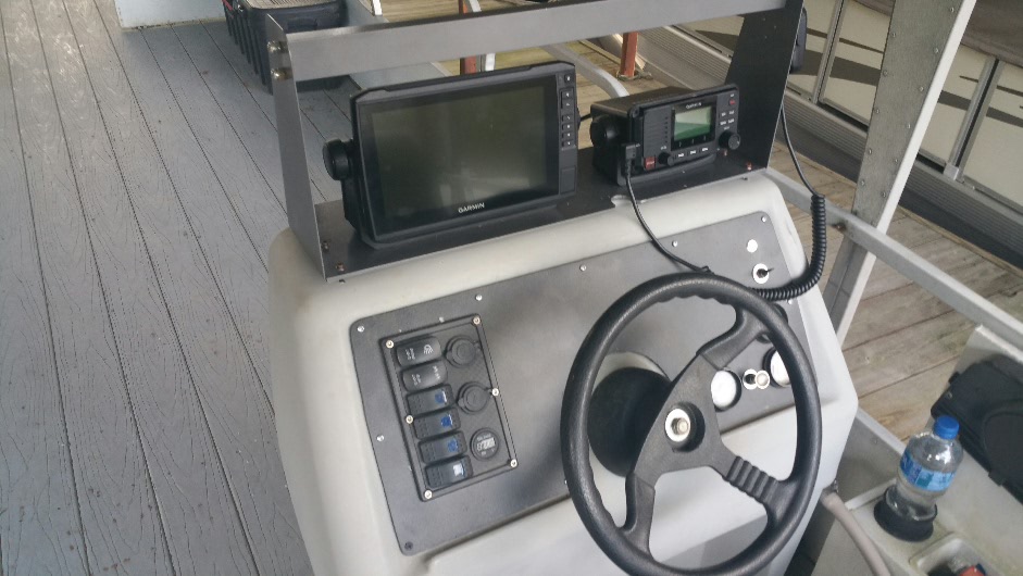

and sitting on console, I drilled 6 holes in the top for the bolts and 1 center hole for cords wires and the Quick disconnects are shoved in the cubby hole in a zip lock bag with an old kooz as camoflauge
2018-05-31 18.54.56.jpg (138.29 KiB) Viewed 41031 times
2018-05-31 18.55.19.jpg (112.81 KiB) Viewed 41031 times
everything looks crooked for some reason :donno
2018-05-31 18.55.48.jpg (121.38 KiB) Viewed 41031 times
it is not heavy, still need a couple latches to secure it, and finish the back cover and sun screen
hope it gives folks an idea or two

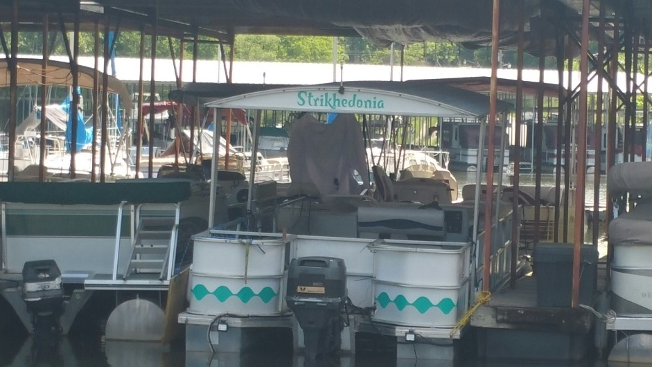

So worked on boat some.
Got her name on, christening ceremony is planned for Sunday
2018-06-01 16.24.07.jpg (125.97 KiB) Viewed 41015 times

#86 Post by TWB » Wed Jun 06, 2018 5:56 pm
Really looks great!
Been meaning to ask you about the name -- Strikhedonia.
