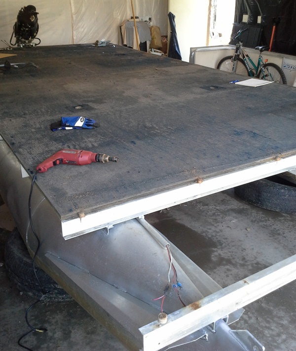

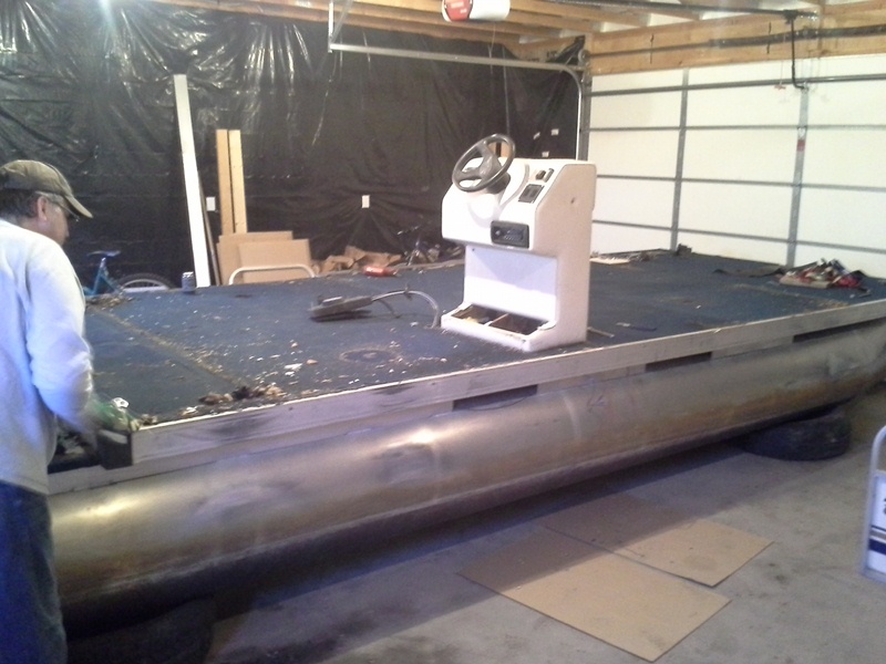

Stuffed it in the garage and started pulling off the old furniture
Getting close to the deck!
Tonight we should finish pulling off the old console and start hole drilling all the deck screws out. Hope to have the old deck off tonight, then we can start working on putting it back together! I'll do some site searching to find out the best way to pull the steering wheel and cabling. I also have to start calling local suppliers for Marine-grade plywood.
Look forward to sharing the rebuild. The only issue we've had so far was the bolts that hold the fencing on. They were long bolts with the three-finger style anchors that you hammer into a drilled hole and the plywood had rotted so they just spun. We had to drill the bolt head off and push them down through the decking. Thankfully the builder didn't use stainless hardware, so it was easy drilling! Have to buy some more beer and get back to it after work tonight!

Finally making a little more progress

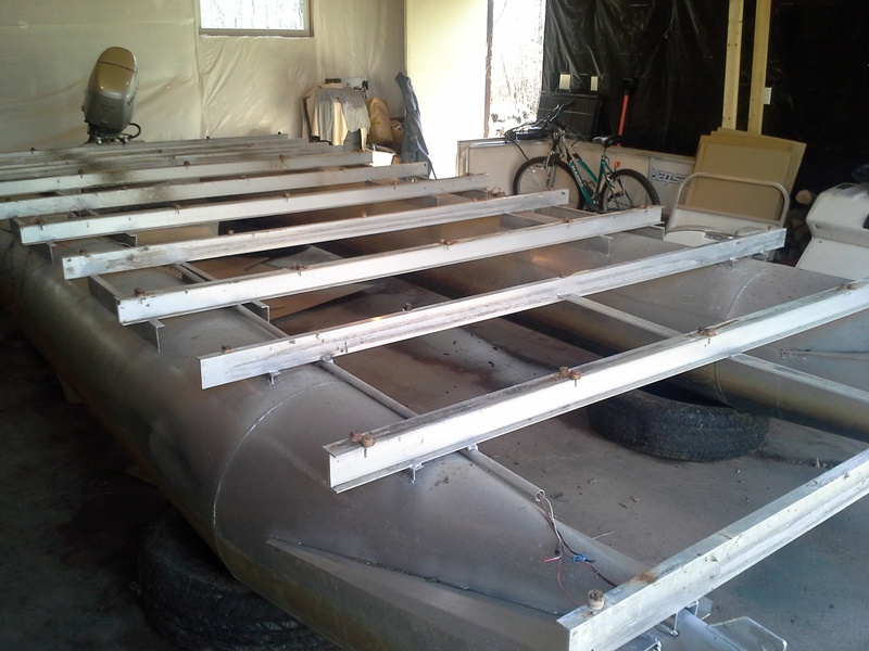

Deck is coming off
All the plywood is removed, still have to cut off some of the deck screws

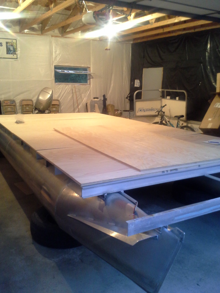

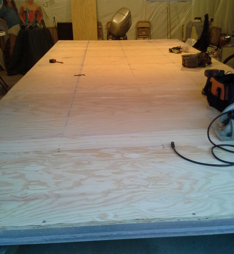

#15 Post by Comstocker » Thu Jun 26, 2014 5:35 am
Got the marine plywood all screwed down

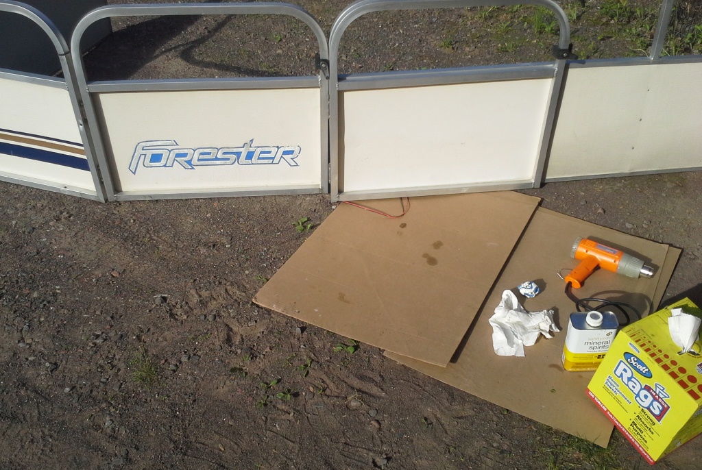

A heat gun and some mineral spirits made quick work of the old gate decals

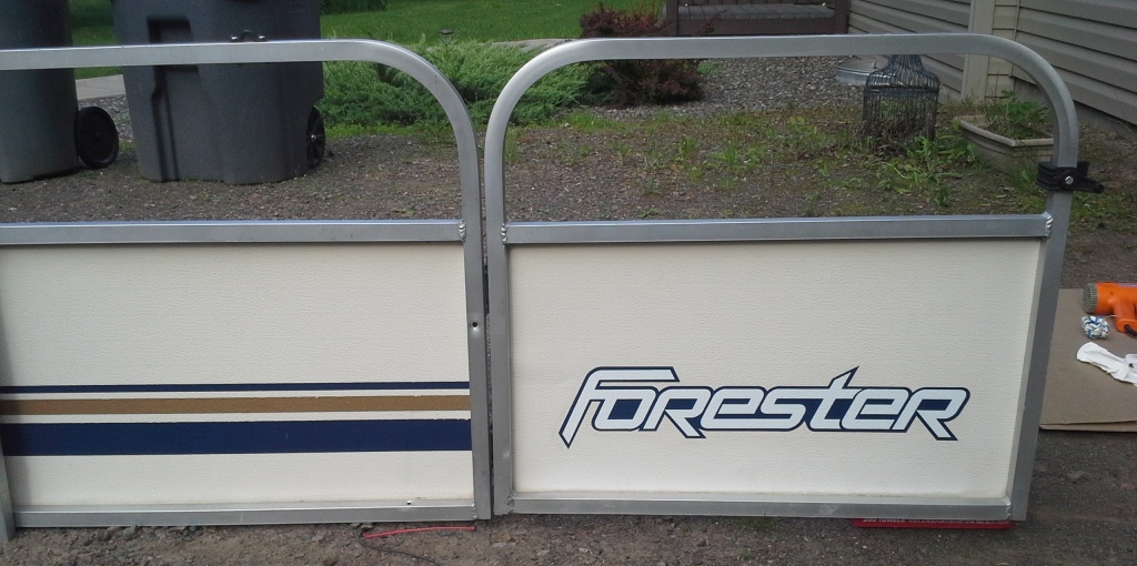

And one of the new decals installed, yeah the blue finally matches!
