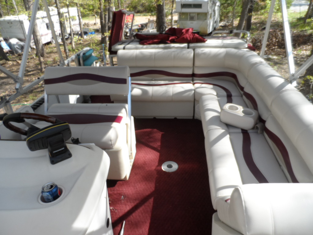

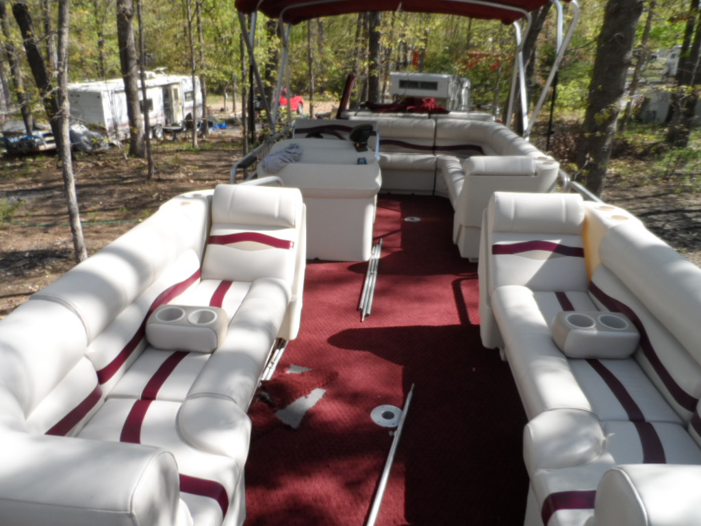

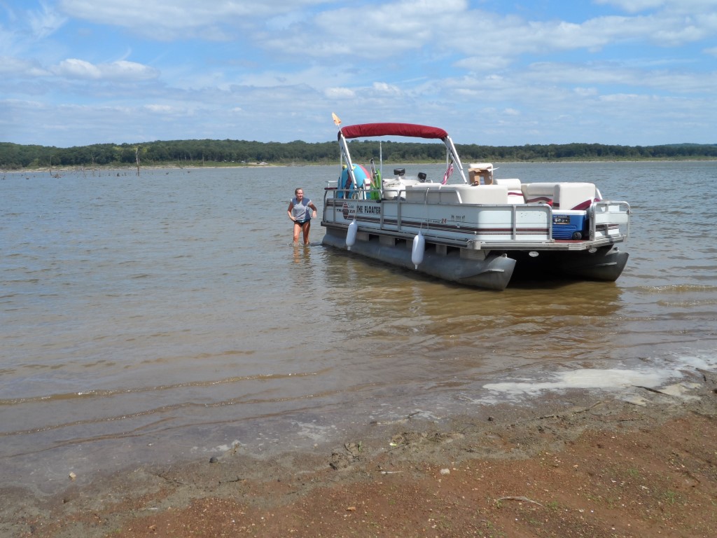

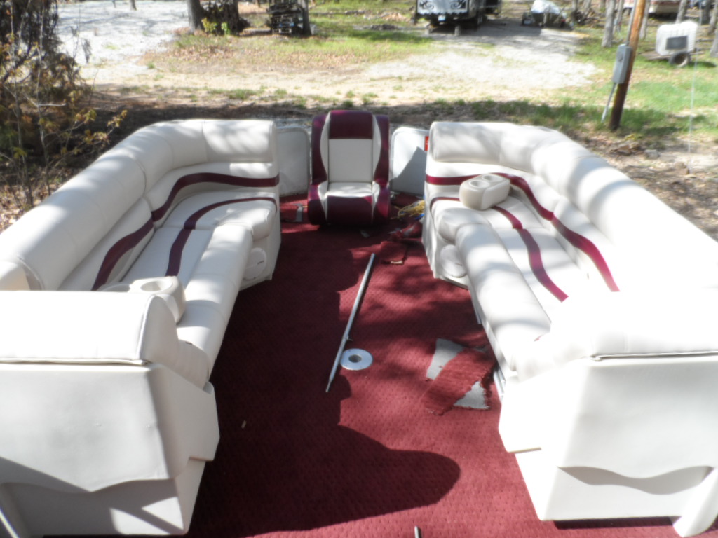

We rebuilt THE FLOATER in 2013. (Link in my sig) lot's of trial and error. Have fun!!!!!!!!! I left my bent nose alone.
