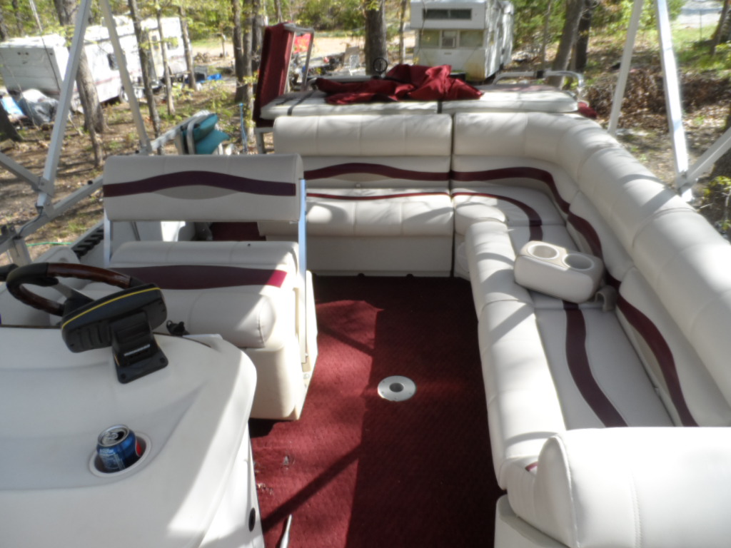

Re: 33 year old 28' Party Hut restoration
#6 Post by curtiscapk » Tue Aug 04, 2020 6:43 am
We rebuilt THE FLOATER in 2013. (Link in my sig) lot's of trial and error. Have fun!!!!!!!!! I left my bent nose alone.
