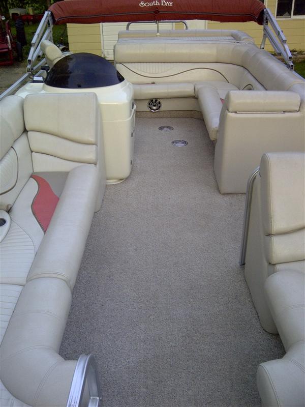

Well, its been a sufficiently long time since I received and installed the Polk db651s.. A few pictures are in order.
Floor Plan
Front Speakers
Rear Speakers
The wife loves them, much better sound. I have not mounted the 10" subwoofer yet, partially because I am not super thrilled to be the one that gets to cut a 9.25" hole in the upholstry in front of the helm, and partially because I am going to need a bigger amp for it. No sense in doing permanent damage until we are happy with the sound quality. Currently the 10" subwoofer is mounted in a very small box for testing purposes, and not seen in these pictures.
I found that I am going to have to re-run the speaker wires, whomever wired it the first time left "just enough" wire to reach the speakers and no additional length, so if you see that a speaker or 2 is not 'straight up and down' or 'off kilter' its because the wires are so short that I could not rotate them properly :x I also found out that whomever wired it the first time was an inattentive of how they wired it, with fade and balance, I assumed that the front speakers would be the front and the rear speakers would be he rear, same thing with left and right.. but no. The front right and rear left are on the 'Front Channels' (left is left, right is right) and the front right and rear center are on the 'Rear Channels' (Right is right, center is left) :donno
