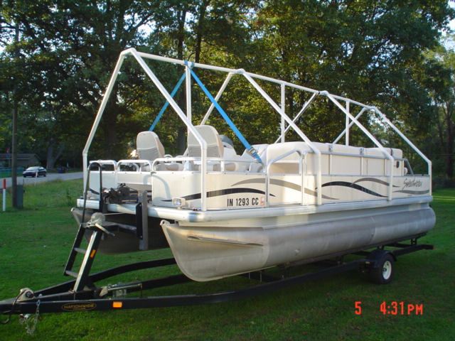

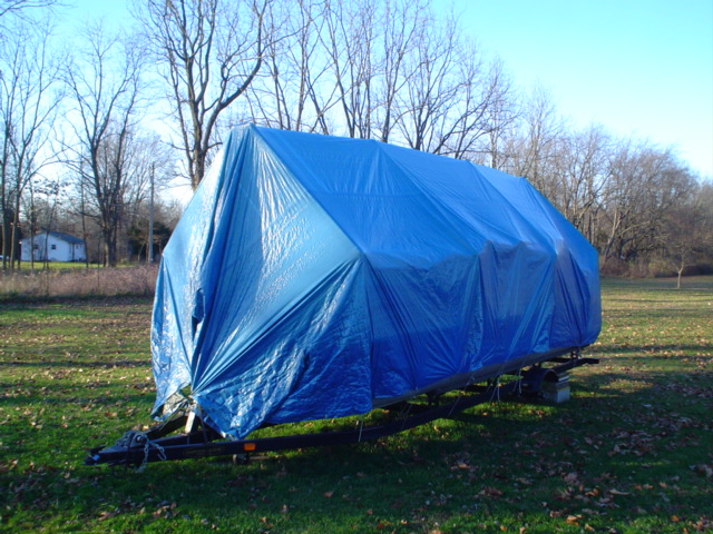

I used 2" PVC #40 and it works out fine . I live in northwest Indiana and this set up work great.

Wow, dubldown that is an impressive piece of work, but probably just about
right for Indiana, What type of fitting is used at the peak of the first, third,and
fifth section? old jim
