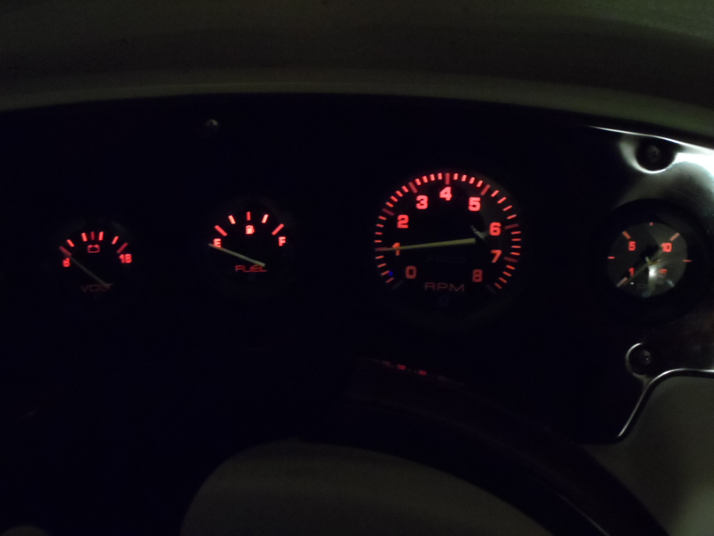

I watch my water pressure gauge ALL the time. Power for the light and a water line to motor is all you need.
Google psi port for your motor.
My fuel wasn't working..I think it was the sending unit.
not sure how much trim would be used...
- SAM_0548.JPG (292.83 KiB) Viewed 1518 times
