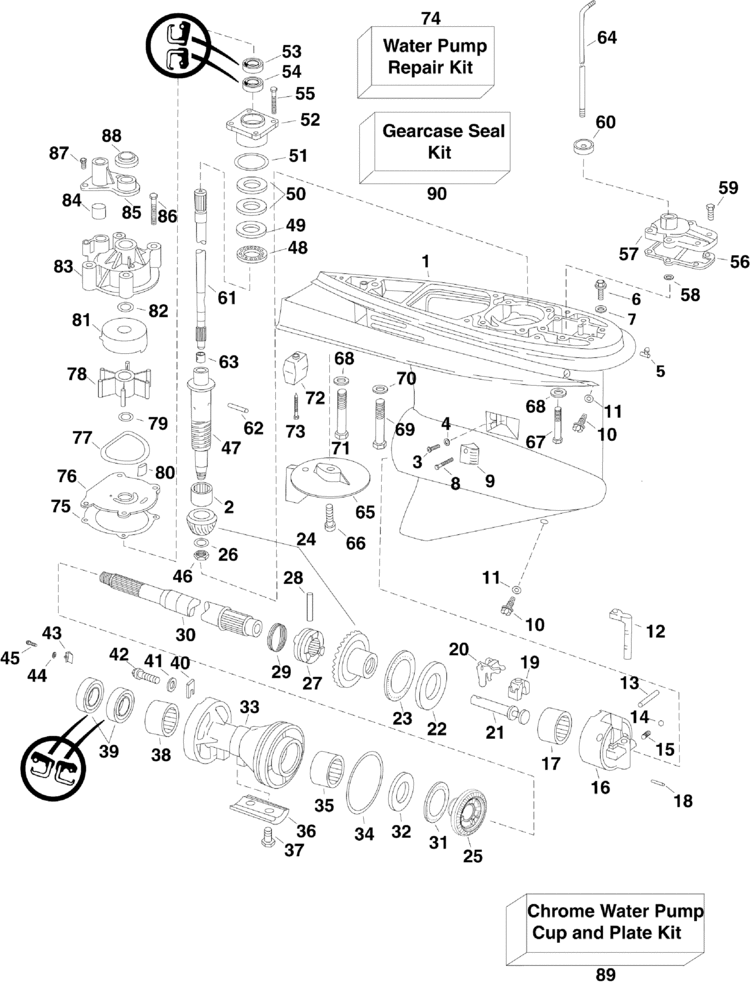

needs to be replaced. To reach the anode, the prop bell housing must be removed. Has any one tried this? Or, should I have my etec service tech install it.

Thanks for the reply Bamby but that's not the one. This anode is behind the prop, inside
the gear housing. I'll take some pics tomorrow.

From E Tec forum
" Hi, there are no internal anodes like the Yamaha has. There are only three (3) anodes on the E-TEC and are located next to the trim/tilt unit near the bottom,there's one just above the AV plate and you can see it,the last one is fastened to the bearing carrier in the lower unit. Cann't get at this one unless you take the carrier out of the lower unit."
Re: Replacing anode on Etec
Yeah there is a bearing carrier anode (#36). Depends on how skilled/experienced you are as a tech, but you are opening the gearcase up. These service techs at marinas have done so many they could probably do it in their sleep.

It's visible if you remove the prop and shine a light inside the lower exhaust relief port.HandymanHerb wrote:So how did you know it was bad?????
BMR is correct. If you tilt the motor up, it's easy to see. My thought with this why evinrude would have a anode here. Everything else is pretty easy as far as maintenance.
