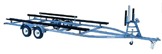

blow out on a two lane hiway last summer - scared the hell out of me when it blew...
Uploaded with ImageShack.us
Re: G3 V20 with an F90
yep,.. they have the PB-13-20 tandem rated for 3512...i guess that is the one to get.ROLAND wrote:He speaks the truth!!!!1roadking wrote:Get a dual wheel trailer and be done with it. If a tire blows on a single axle trailer it's not going to be pretty!!!
- trailer.jpg (15.31 KiB) Viewed 2811 times

Yes, and because it's rated under 3,000 pounds, it will probably have no brakes.motocross wrote:check out the specs on the V20F they have a package weight of 2805..not sure what that means..boat with trailer?
Get the one that's rated over 3,000 pounds, and it will probably* come with brakes - either electric, or surge. I prefer electric.
* The weight limit for requiring brakes is 3,000 pounds in 33 of 50 states.
