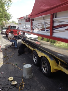

sharkhide
photo (7).JPG (40.12 KiB) Viewed 2659 times
