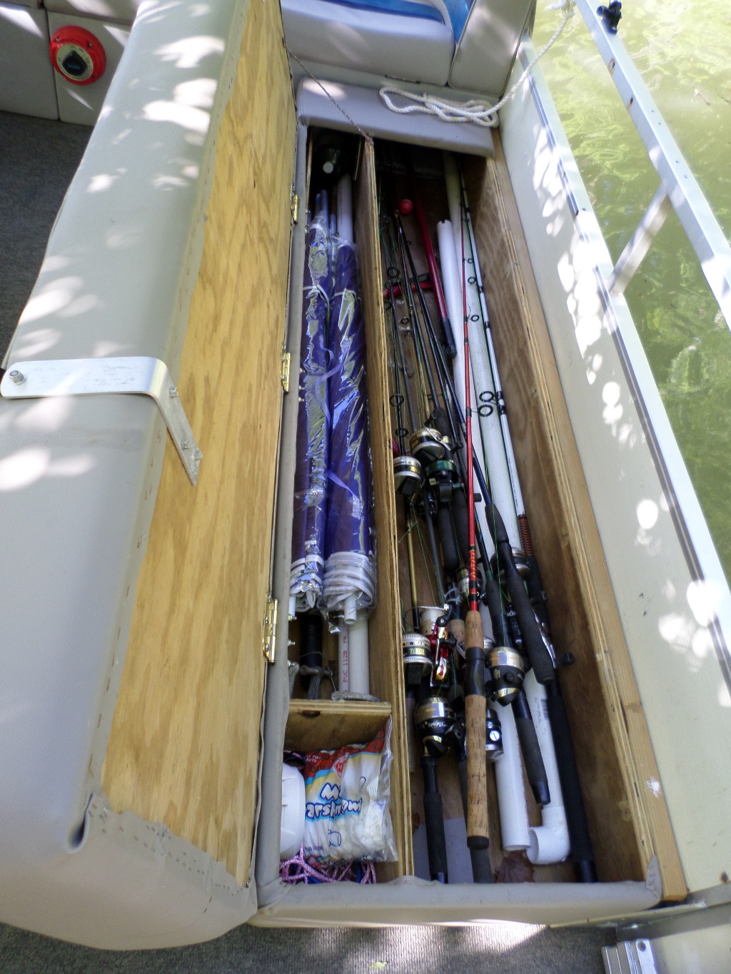

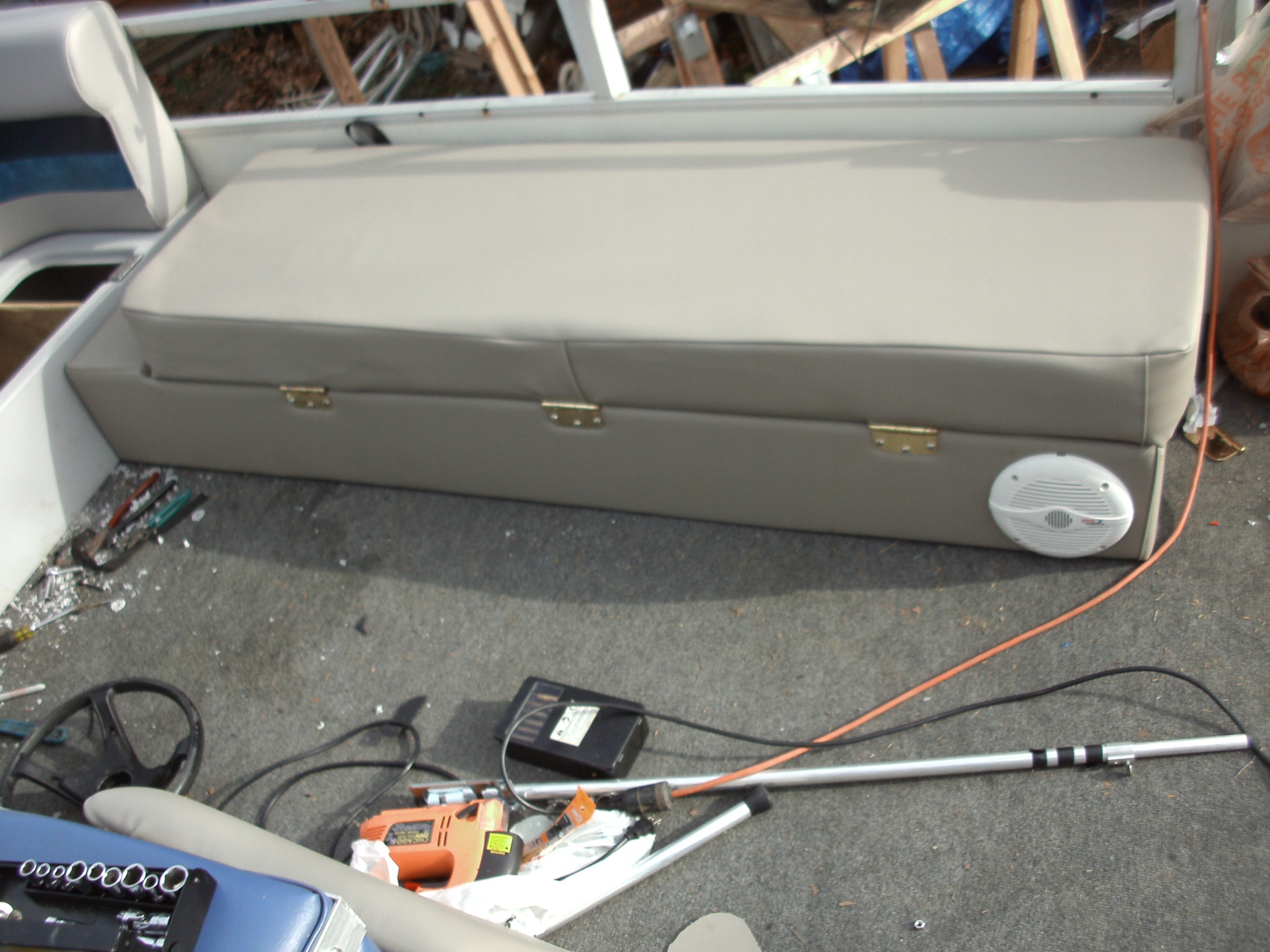

Or you can do this.
- bench 2.JPG (444.48 KiB) Viewed 5207 times
- bench.JPG (713.53 KiB) Viewed 5207 times
