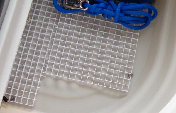

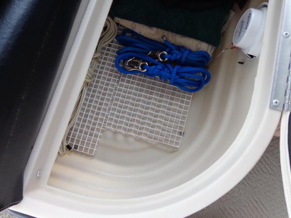

#11 Post by landlockedsailor » Sat Jul 06, 2013 11:35 am
margaritaman wrote:Try this!
http://m.youtube.com/watch?v=hoKXTlqmUb8
Have you actually tried Never Wet? From the video, it looks like all it does is turn the water into droplets. Stuff under the seats would still be sitting in water?
Don't have leaking or condensation issues (yet; haven't been out in a storm) but we cut these plastic grates (lowe's) to fit on the floors of each of our under-seat storage area. Ounce of prevention and all that.

#12 Post by redbeard » Mon Jul 08, 2013 7:30 am
Nice line work there landlockedsailor always looks good in your photos I like it.

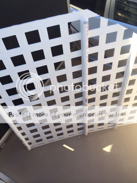

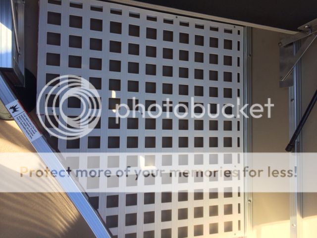

#13 Post by Reiner » Thu Dec 18, 2014 10:35 am
I had a water problem under the back lounge seat as it was open to the floor. Not the plastic bucket type I have under the seats. I raised the floor with plastic lattice cut to size and used SS screws to attach 1" PVC pipe. Now water can drain and my stuff stays dry.
