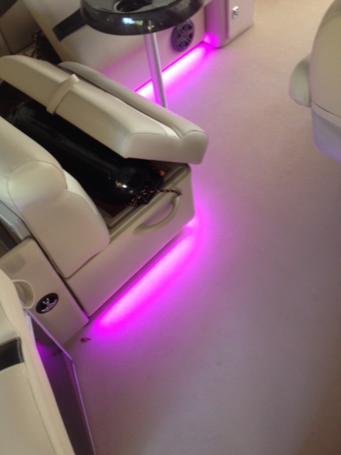

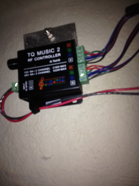

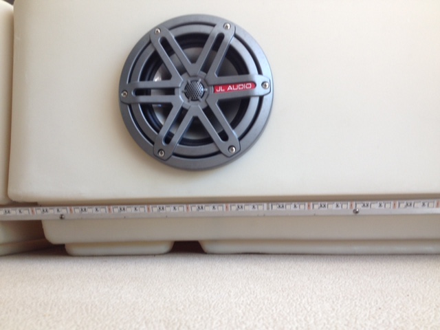

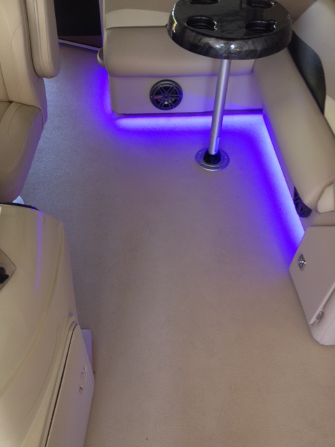

I installed lights around my seat bases that turned out great. I didn't want rope lighting and I wanted multi color so I pieced this system together. I mounted the lights to a piece of 3/4" aluminum with 3M automotive tape and bolted that to the seat bases so I could take them out if I ever have a problem. I thought that would be easier that taping them to the seat bases and an easy way to get them straight. You can not see the lights from sitting in the boat. The controller I used is an 18 amp, 12 volt controller with music control option and the lights are 100% submersible. Here are some pics.

I use aluminum to mount LED strip for places in my house. For my boat, I used the Klus extrusions. It's good to mount them on aluminum of some type because there is some heat generated and the aluminum helps the heat dissipate. I was going to mount mine low like that but didn't feel there was enough light being distributed across the floor.
Did you use waterproof LED strips?

babock wrote: Did you use waterproof LED strips?
The strips I used are advertised as having nanometer waterproof technology.
"IP68 Waterproof LED Strip Light New arrival
This is a complete new IP68 waterproof led strip! With Nanometer waterproof technology, You can soak it in water! The PCB of led strip is coated with a layer of nano film, which can make light work perfectly under water! With IP68 waterproof grade, this led strip is perfect for Swimming pool, ponds, fountain, aquariums, recreational facilities, decoration underwater, park lake, water stage and other outdoor place."
I mounted them at the floor so I didn't have to see them. The controller I got allows me to dim them or brighten them up to the point they're too bright.
