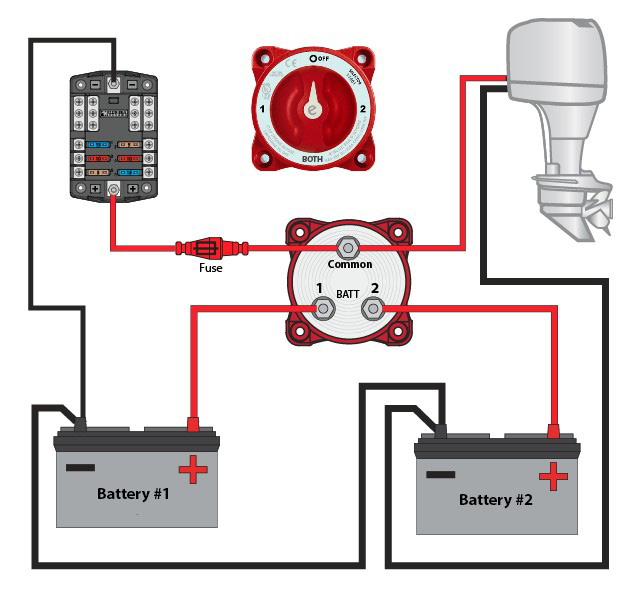

Heres another one
battery switch.jpg (92.58 KiB) Viewed 3117 times
