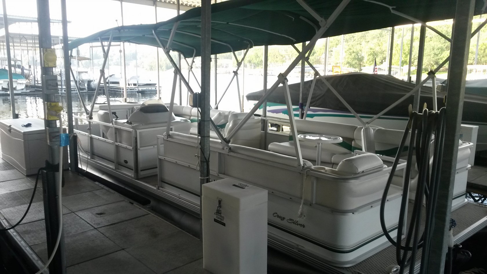

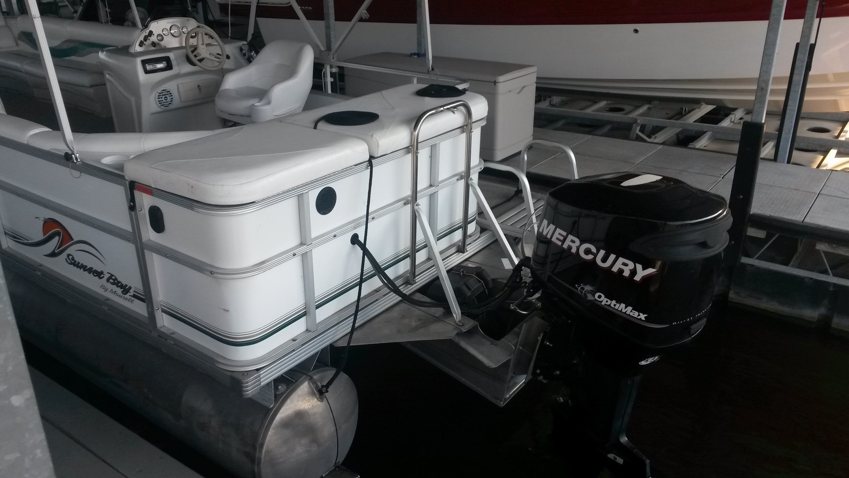

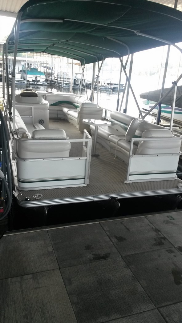

I'm a new member and was asked to post a few pic's of my Tritoon. It is a 2008 Sunset Bay Cruz 250 with a Mercury Optimax 150 HP and as you can see double bimini's too. Here they are the pic's..... I am starting to plan for underskin for my Tritoon and am looking for advice. I am considering .063 aluminum sheets as my cross members are 24" on center. Has anyone used .040 for underskinning with 24" centers? Thanks.
