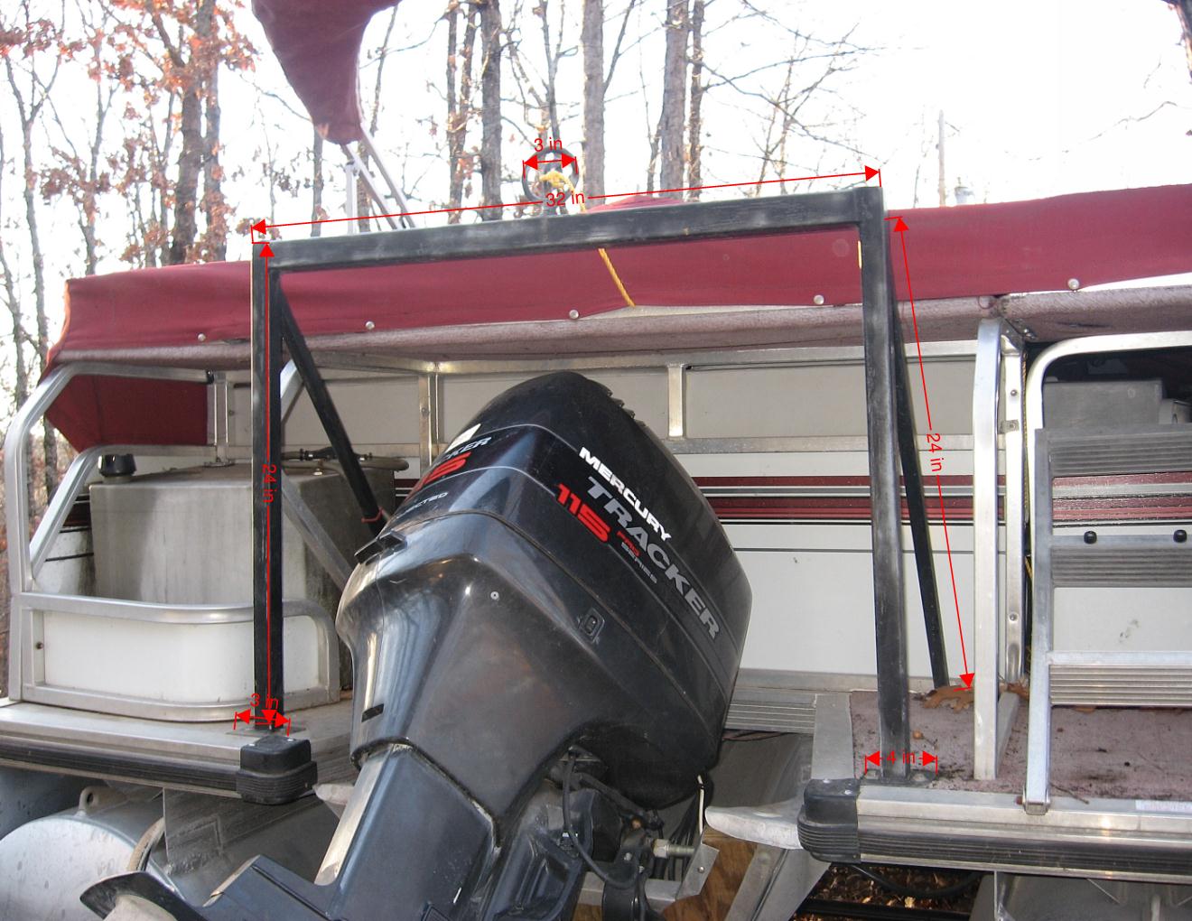

Mine was already on THE FLOATER when we got it. a local weld shop should take care of you cheaper.
- tow bar measured.jpg (183.19 KiB) Viewed 4146 times

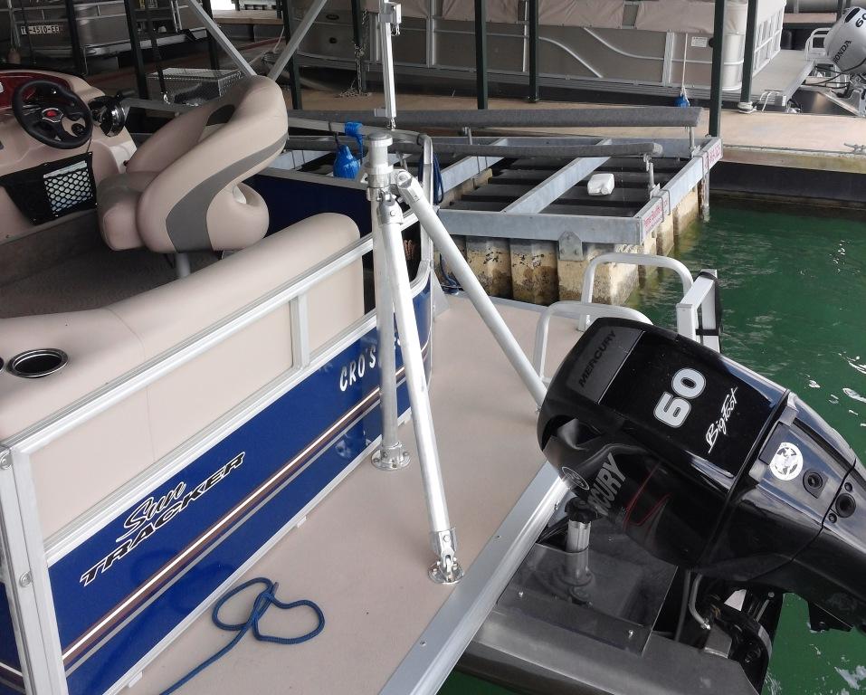

Rolled my own from alum handrail fitting and pipe all found in the http://www.mcmaster.com catalog delivered to the house and built with common hand tools; no welding... It is tested and it is strong.... Used 6" x 6" x 1/4" alum plates under the decking at the bolt down points to spread out the load... Investment was at best 250.00

Re: Towing Set up???
Thanks to everyone for all of the input...
I am looking for ore of what curtiscapk. and teecro have. Mine is set up more like "The FLoater" With the enclosure over the engine. So room is tight.... teecro, I would have never guessed that was not "store bought"- that looks awesome!!!!

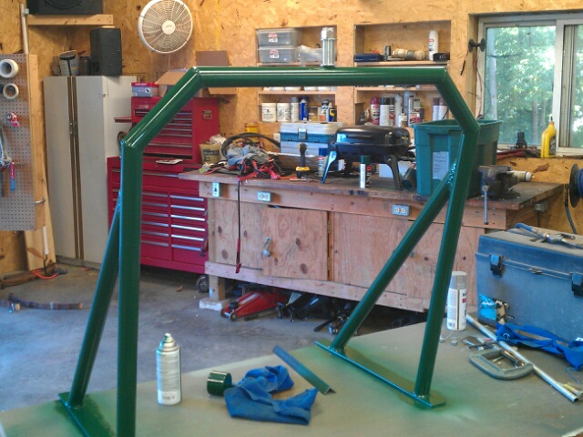

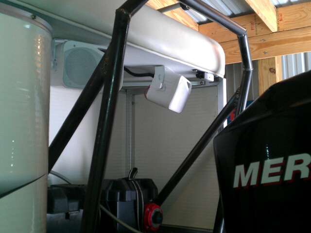

Here is the one I made. I made a mock up of it with wood first to get all the angles figured out. Then I welded it up.
kryptonite- That is sweet!!! Exactly what I need-
