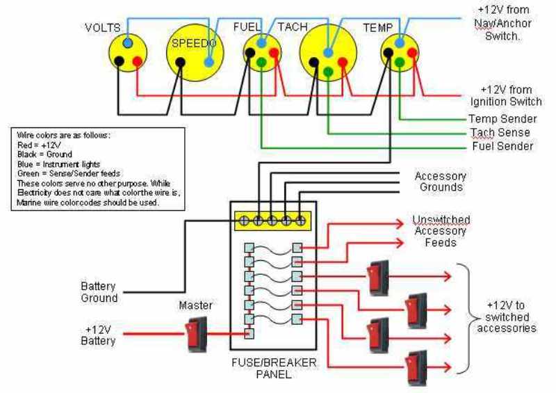

try this.
- InstrumentPanelWiring.jpg (46.64 KiB) Viewed 4158 times
