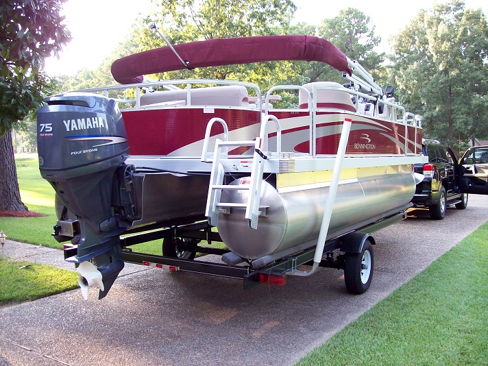

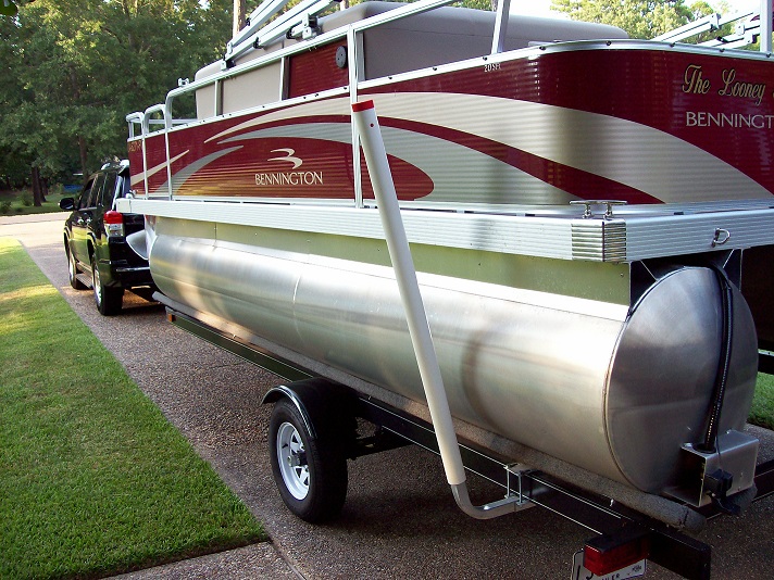

53Powell... don't know if this is what you are referring to, but I added these trailer guides to my rig and it helped tremendously...makes it much easier to line up when loading..

53Powell, I feel your pain. I, too, am considering guides for when I launch in moving water/wind. But I'm leaning more toward external guides like Roland did, primarily because I ultimately want to add the pontoon water glide underneath. (http://www.pontoonwaterglide.com/index.asp)
In the meantime, I learned not to back my trailer as far into the water as I used to do for v-hulls. I leave a good third of the trailer out of the water and use the throttle to drive the toon up onto it. Obviously, if you use a really shallow ramp where your motor has to be raised to load, that technique won't work. And even when it does, I've smacked the pontoon uprights really hard a couple of times until I got the hang of it. But when enough of the toons are in the bunks, it stays straight.
