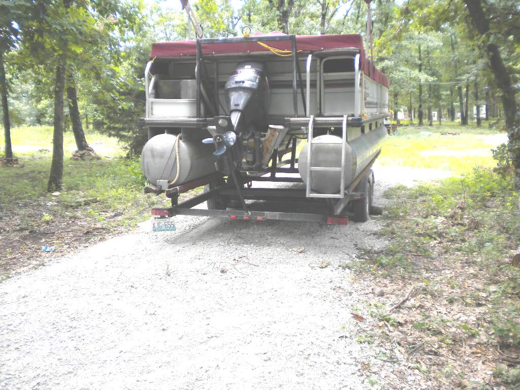

always use it stored and trailering 5 miles....
- DSCN1588.JPG (159.69 KiB) Viewed 1565 times

ok, hate to keep bothering you guys with this ts stuff, but is there a certain length TS I should get for a pontoon boat? When I've looked on them on line they come in various / adjustable lengths... not sure which I need.... also, I'm assuming there's a bracket that has to be mounted to the cross member of the trailer correct? LIke I said any recommendations / links / is certainly appreciated.
Editing this post after I came across a youtube video for a different kind of ts....After watching the video my first impression was " pretty cool"... but then It dawned on me, it doesn't really distribute any weight of the motor to the trailer, so all the weight is still on the transom, and isn't the purpose of the TS to take some of the weight off the Transon? in addition to the questions above... what do you guys think?

Not to change the subject, but ROLAND is your cavitation plate much lower than your motor pod? Your motor looks a little low to me.
2014 Regency 254
Mercury 250L Verado
Mercury 250L Verado
Re: TRANSON ISSUE
Steve, I don't think so.... I know in the second pic the motor really looks like it sits too low, but that's just the angle of the pic... it's not nearly that low.STEVEBRENDA wrote:Not to change the subject, but ROLAND is your cavitation plate much lower than your motor pod? Your motor looks a little low to me.
